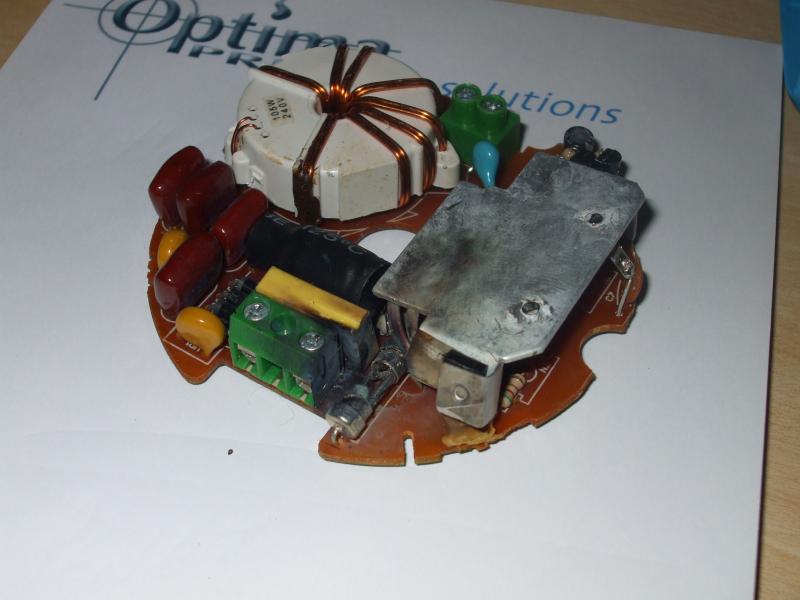

Took the light apart this evening to try to find the problem and the only way I can replicate the continuity flicker is with my hand touching the light so I guess that my hand is providing the slight continuity path (9v tester).
The transformer fuse may be the cause of the problems, in blowing it spread metal/molten glass around the transformer.
Anyone any ideas where I can get a similar round transformer??
If you are competent with electronics, and soldering, you can repair it. You will probably find that the 2 power transistors are shorted. Replace them with two BUH 150 (RS stock No. 544.9494). These are higher spec transistors that should last!
I expect you will also need two 2 ohm resistors that are connected to the base terminals of the transistors. You will also need to replace the fuse. Use a 2.5 amp solid state fuse (RS Stock No. 226-0715), these are 54p each, and you have to buy 10. See if you can source them elsewhere.
If you are not confident in doing this, then buy a replacement unit from www.lamps2udirect.com/pages/fullProd.php/Aurora-RD105-Round-Transformer/67594
