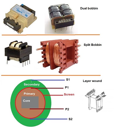

The other thing I would be concerned about is the source of the ELV ( Extra Low Voltage ) supply. My choice would be to use a supply that has a dual or spit bobbin transformer to ensure is adequate and resilient isolation between mains and ELV.
Someone standing in water on wet / flooded land could receive a significant shock from a 24 volt supply, unlikely to be fatal but very disconcerting to a drainage engineer working in the stream / culvert and unaware of the cable.

With regards the dual bobbin how would I choose one with suitable protection?
Specifications of the power supply - which will be an older type with a proper large and heavy transformer in it.
Not some modern switchmode piece which will weigh next to nothing and have a thin layer of Kapton tape between the primary and secondary sides.
