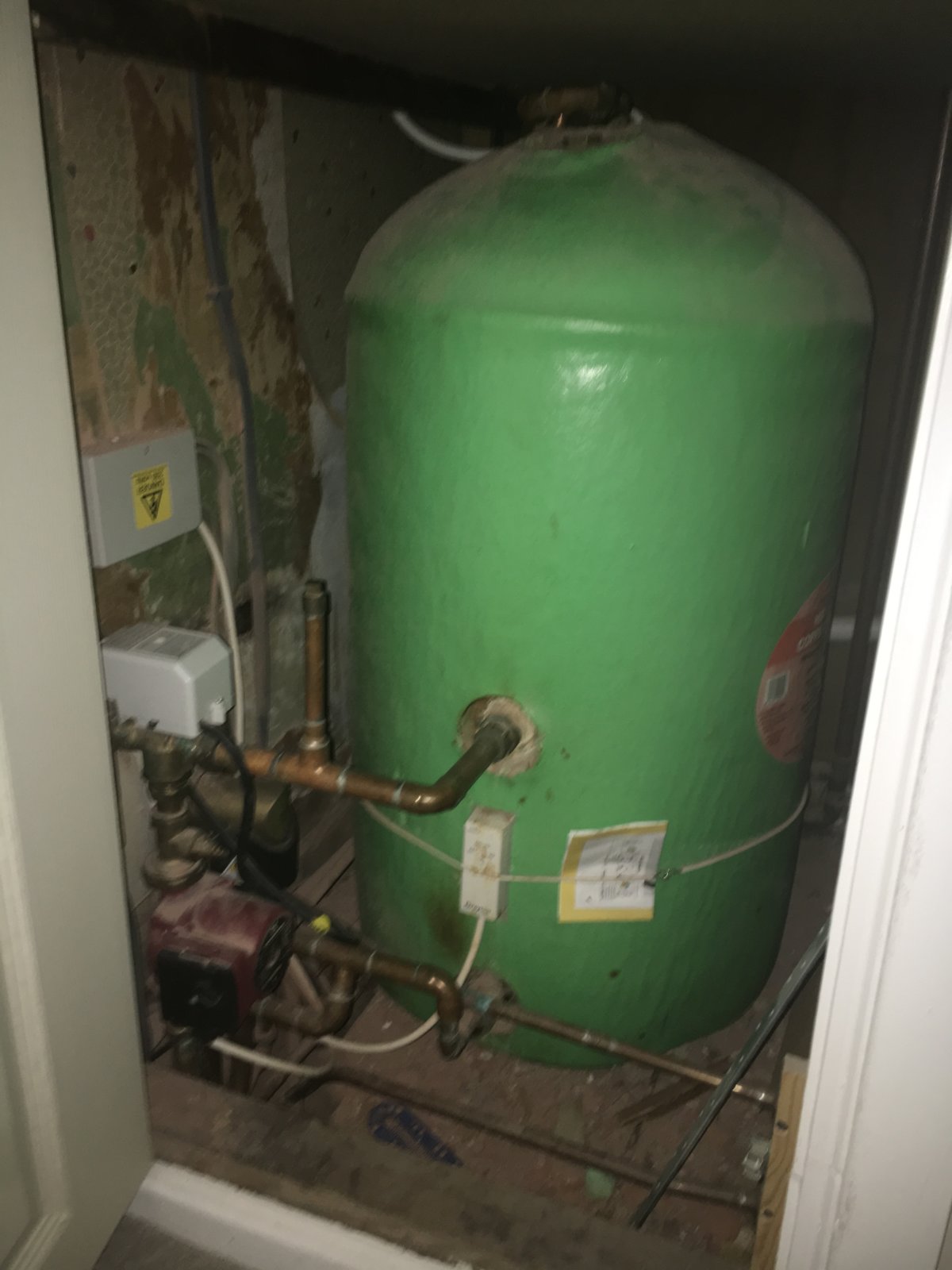

That’s what I have hot water wise ... sorry but I’m not sure what size it is.
The cold water tank above it is aboit 2ft x 3ft x 2ft

My old cwt was about that size but it was only about 80l. I recently went through the whole water pressure / showers malarky and looked into this in detail and 80l would last about 5 - 7 mins pumped to a mixer before it ran out. I actually ended up with a 210l unvented indirect cylinder which works great for me but it wont for you as you want to run two showers simultaneously and your water pressure is naff.
