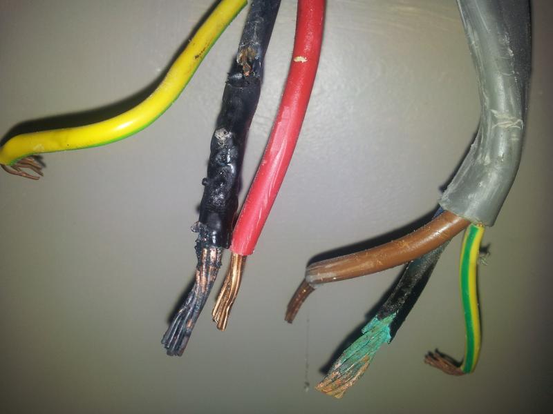

The black/red cable is the supply from the CU, and the new blue/brown is the load to the shower
The shiny bits are some sort of liquid, although there is no evidence of any cause in the loft above

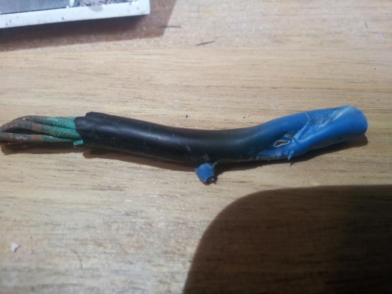

The load neutral insulation is heat damaged, but also has mechanical damage
The blue neutral has corrosion and the insulation has come away from the block - the insulation was there when fitted
All connections are very tight
2. Cables in more detail

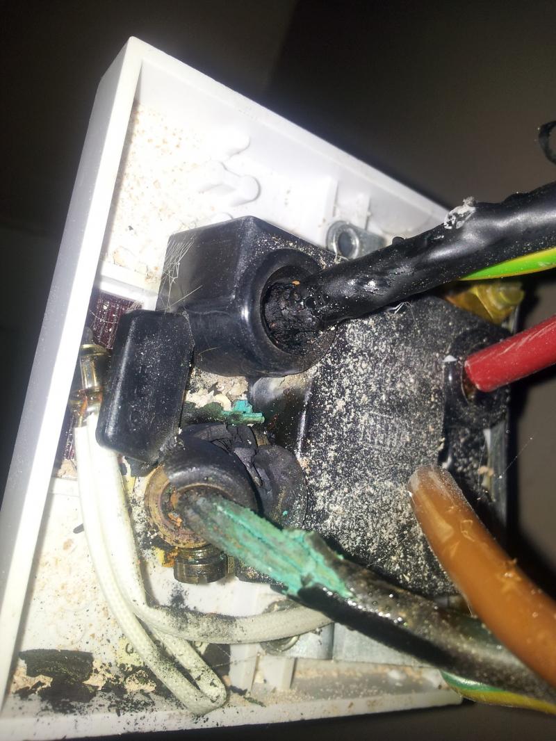

3. Cables in the fitting
Note the liquid

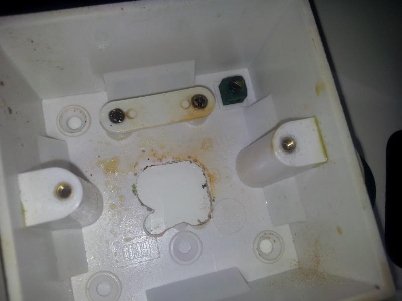

4. Inside the ceiling pattress
The liquid is yellow/brown, and it smells. Note corrosion to earth block and cable screws
5. Corrosion to load neutral
Also it seems mechanical damage and loss of insulation - this was just hidden by the outer sheathing
Loose neutral connection is the cause i am afraid. That is a common problem with pullcords that have a single screw clamping down onto a multi stranded cored cable. Especially on newer high current appliances
The liquid you refer too will have been caused by the heating action of the loose connection melting the plastic of the PVC and releasing an acidic compound, this will also account for the corrosion on the cores.
Nick
That is as simple as it gets. The only cure is to regularly inspect and re-tighten.
I'm pretty sure that PVC doesn't release acidic compounds until it actually burns.
The green gloop here is more likely to be Di Octyl Phthalate
Unlikely with modern cables. AFAIK it was only a problem with cables manufactured 40ish years ago.
You may have a point there...
Although I suppose it could happen again, with a cost-cutting manufacturer buying sub-standard PVC.
I've got experience with green goo (via personal injury claims), and there was non in this case. It was purely a green patina on the exposed copper
I was curious as to what occurred first - was the liquid the cause or result of the burnt cable and did it contribute. But now I know.
There was never any burning smell though
