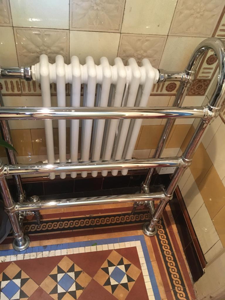

Below is a photo of the only used radiator I installed (everything else was new), it is not very big and even flushed it with the garden hose before installing it:
Below is a photo of the water drained through the magnetic filer:
Because there was a bit of sludge in the flow CH pipe, I was told I had to clean the whole system (ie there should be no sludge going through the magnetic filter / boiler all the way to the flow CH pipe).
I appreciate that radiator might have introduced a bit of sludge, but I would have expected the boiler being able to cope.
I was told I had to clean the system, and they would do a good will gesture replacing the pump if it seizes.

Nope, he took some photos though.They all carry test kits, did he take a sample of system water for analysis?
