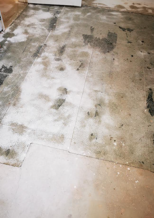

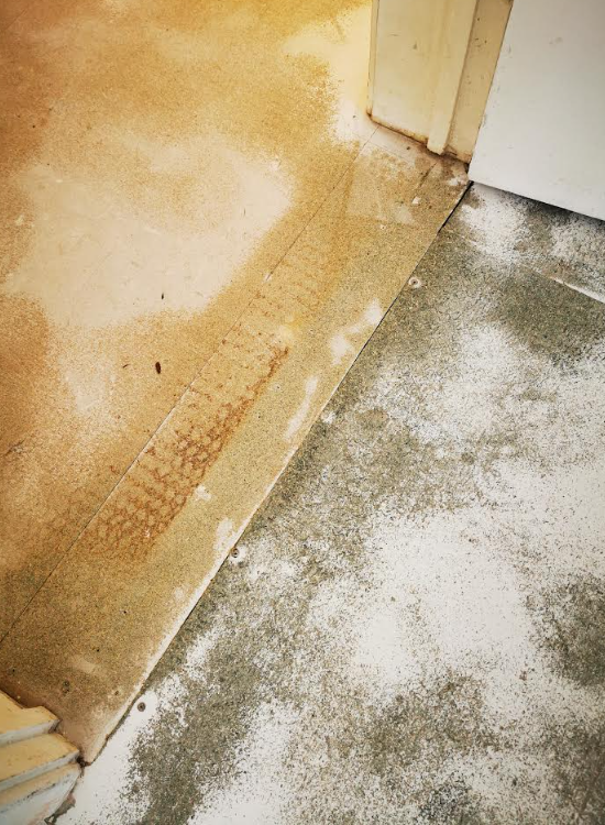

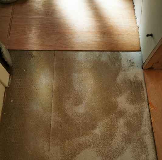

Suddenly this is amounting to a huge amount. Without cutting corners, I'm looking at the current wooden subfloor it's tongue and groove plywood it doesn't move only at the x2 door threshold part where there is no tongue and groove. I'm rethinking if the plywood is a good idea or not, or if there is another way here. The floor doesn't move only when say the washing machine is on vibrating most of that area.
Can I cut and remove the thresholds that are not using tongue and groove and replace with sand/screed? My idea here is to go without the 6mm plywood altogether providing a huge cost saving on self levelling screed, again without cutting corners would like to know others thoughts.
Couple of pictures however understand that someone would need to view this in person to get a feel for the work required.
Where extension meets subfloor:
Door threshold movement:
Ply wood on subfloor:
