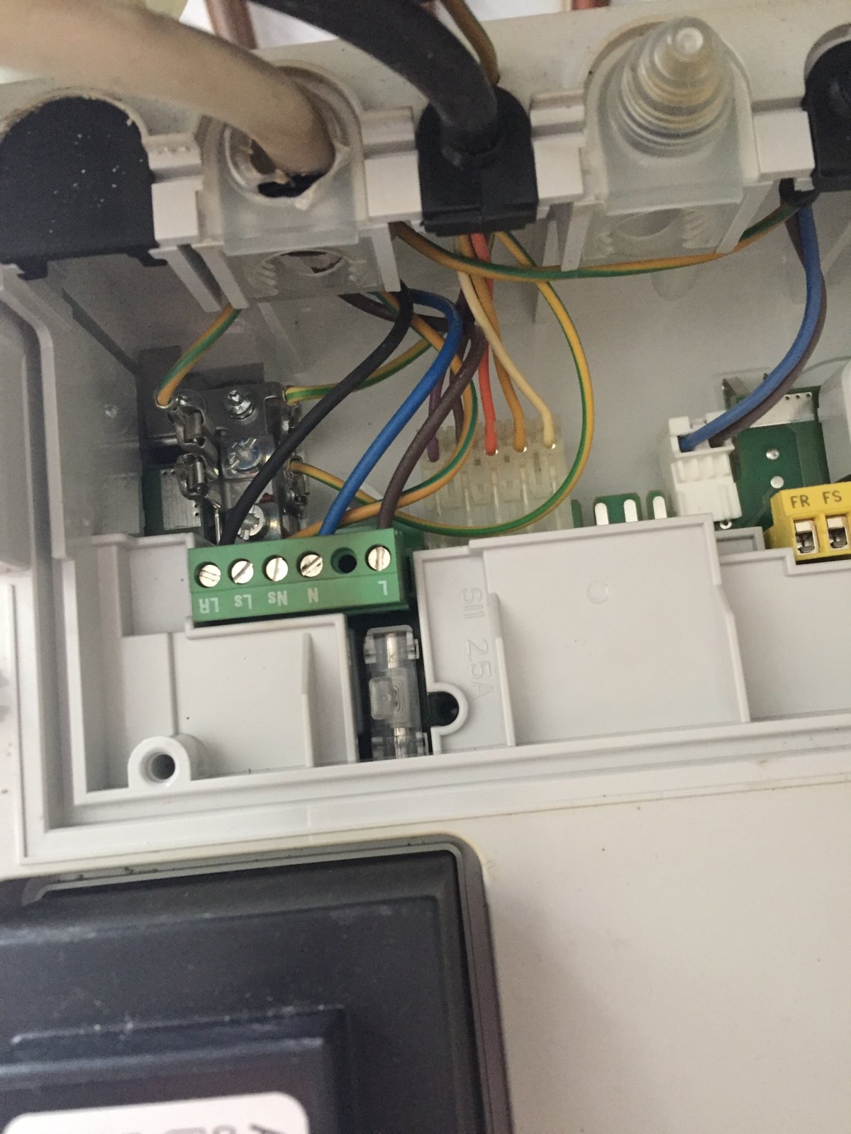

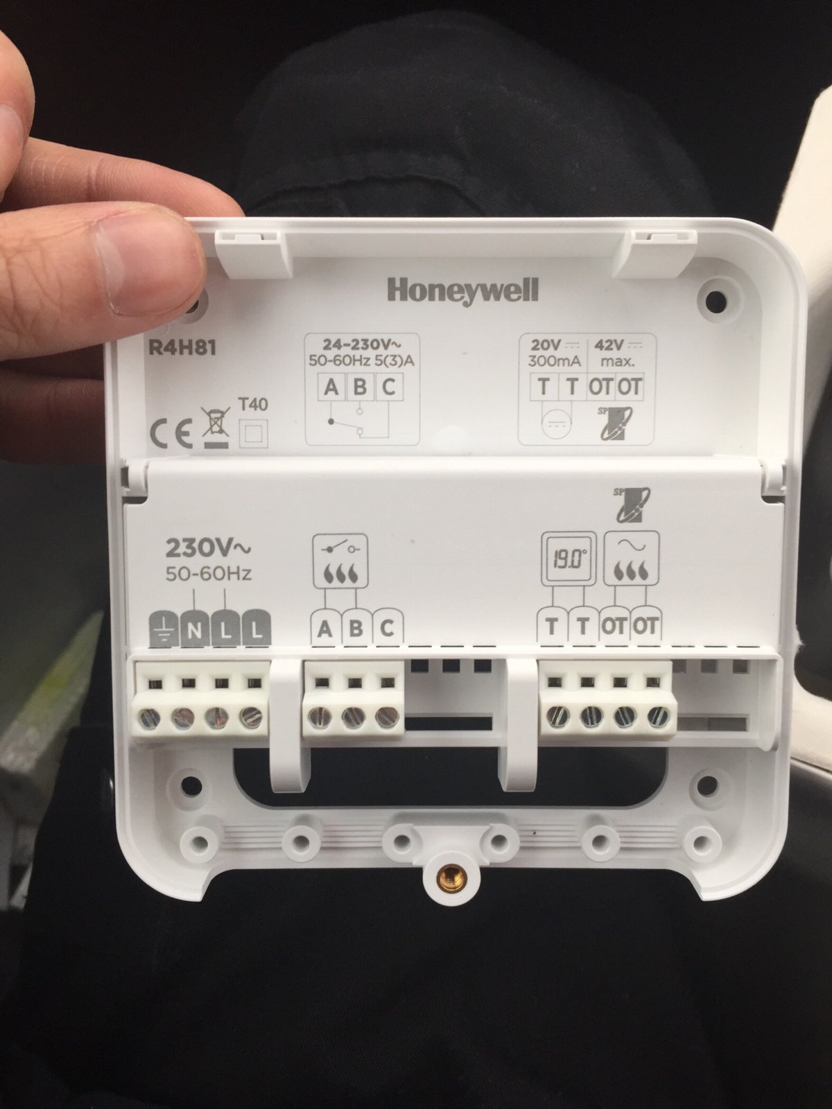

Hi,
Going to install new lyric t6 and I know this is pretty simple but just need confirmation
From the picture
- TT - two wires from wired room theromstat
- Live + neutral from the fuse spur?
- Another live and neatral, link from second L to A, and B to boiler ( Live, neutral, B to boiler?)
At the moment, the live supply and theromstat is going in to the fuse spur, and one wire to boiler (live neutral switch)

I would be using Ns and Ls from boiler to power the Lyric and link L at lyric to A. Then B to LR of boiler
That would mean a supply wire from the fuse spur would go into boiler
And then another wire going to ns/ls and Lr,
The only thing im trying to make sense of is how to power the receiver,
Fuse spur into the 240v? Then take another L and N into boiler
Ls Ns powers the receiver. LR gets the boiler working
