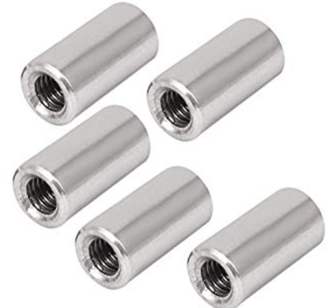

I have a small lamppost fixed to the ground with threaded bar (set deep into 2' of concrete). Unfortunately the M8-sized bars aren't long enough to go entirely through the base of the lamppost.
My plan is to use an M8 to M6 reducer as I have a long length of M6 threaded bar which can extend the bar up.
Unfortunately there's only 15-20mm of room underneath the base of the post so I don't have a lot of room to extend the thread. I need a reducer from M8 to M6 with an overall length of no more than 20mm. I can't find them in the UK or even at the local fastenings shop -- the only source is from a seller based in Honk Kong and the delivery time is up to 4 weeks. Something like this:
Does anybody know if this is something available in the UK? Maybe I am looking at the wrong solution?
consider sleeve-nuts
You didn't say how far the bars project above the surface of the concrete. M8 sleeve-nuts will typically be 15mm or 20mm long.

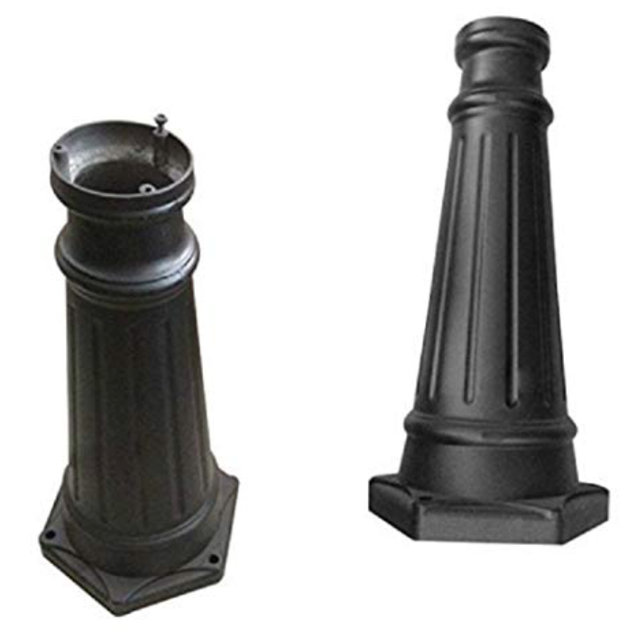

They may work -- I just need to see if there is enough room within the holes/tunnels on the base for the sleeve nuts to go through if you know what I mean. I can drill out further but I'm afraid of removing the layer of protection on the oxidised metal. The picture below shows the lamppost base and the pre-drilled holes for the bar:
The bars project exactly 30mm beyond the surface of the concrete which brings the ends of them almost completely flush with the surface of the lamppost base, which is obviously stopping me from fastening the capping nuts on as there's no accessible thread.
It is aluminium yes so I will pick up some washers from the old man's shed, luckily I do have a tub of nickel grease thanks for the heads up. Cheers.

Unfortunately they are 30mm long which is too long :(
You'll find they'll be 50/50 threaded so you would be able to cut off each end to suit. They won't be hardened steel so you can vice them up and use a hack saw if not an angle grinder.

How about showing a picture of the situation and the bottom of the lamppost?
Thanks all for the very useful information -- appreciate the replies.
I'm going to try @SammyInnit 's suggestion first. I presumed they would be 50/50 threaded but didn't want to ruin the thread when sawing. I'll give them a go and if this doesn't work I think it'll be @JohnD 's advice on widening the thread holes in the base and then protecting with a primer and paint.
