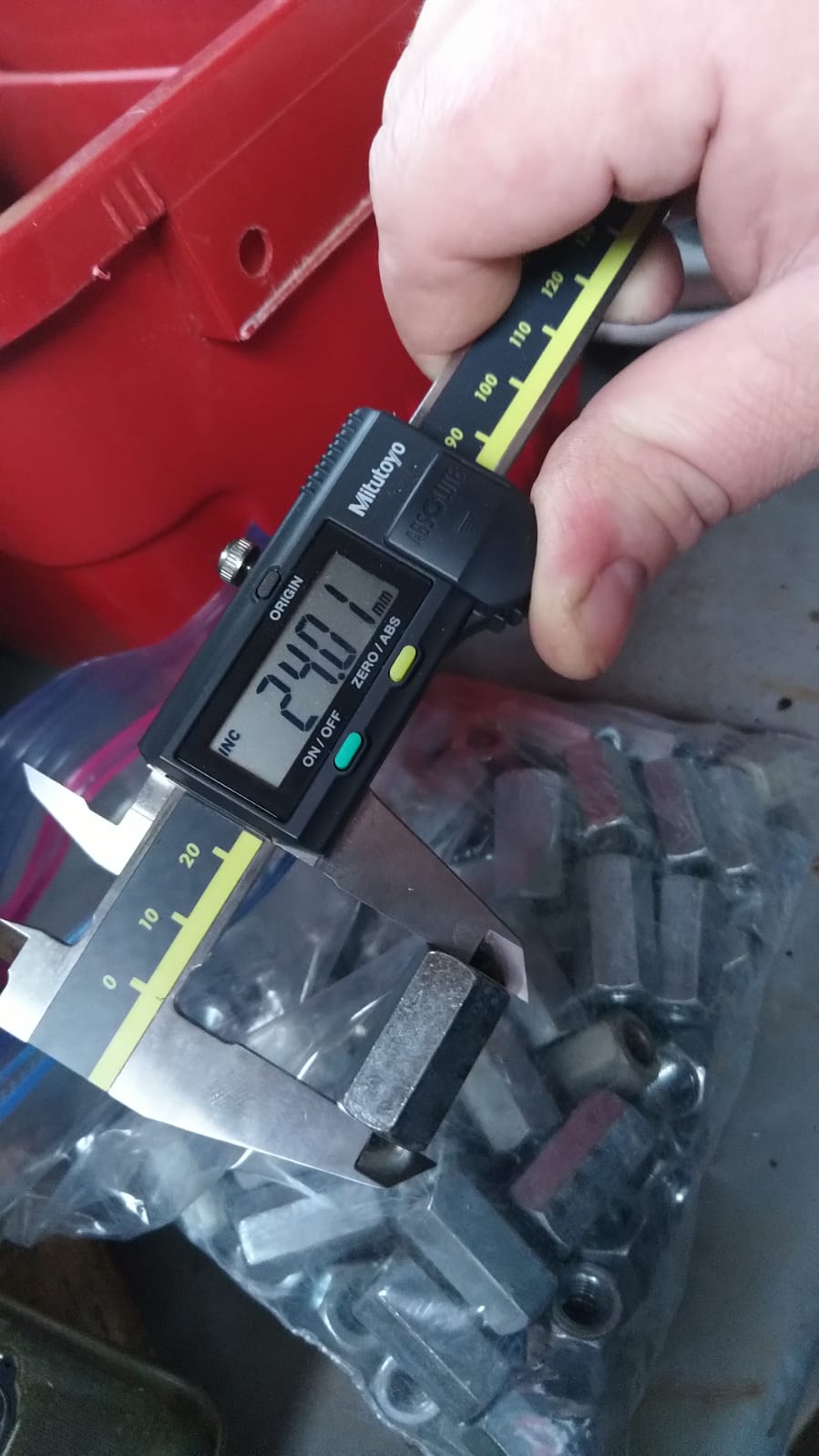

Really appreciate all replies and they have helped me -- essentially the M8 thread I supplied was sunk too deep into the concrete so (ideally) I needed a way of extending it. The only thing holding me back on this was the length of the reducing connector as I wanted to try and find a smaller one rather than sawing. Now I know it's probably going to be easier to saw rather than source, I am doing this. The thread should then protrude around 8mm beyond the base of the post in order for a capping nut to fit on -- none of the threaded rods are seen as previously explained so this...

Okay bit of tit head moment... I picked up the reducers only to find out they don’t fit. Reason being the rod set in concrete is actually M10 not M8 so I need to go and get an M10 to M8 reducer! :oops:
I didn’t measure them properly with the micrometer in the first place.
