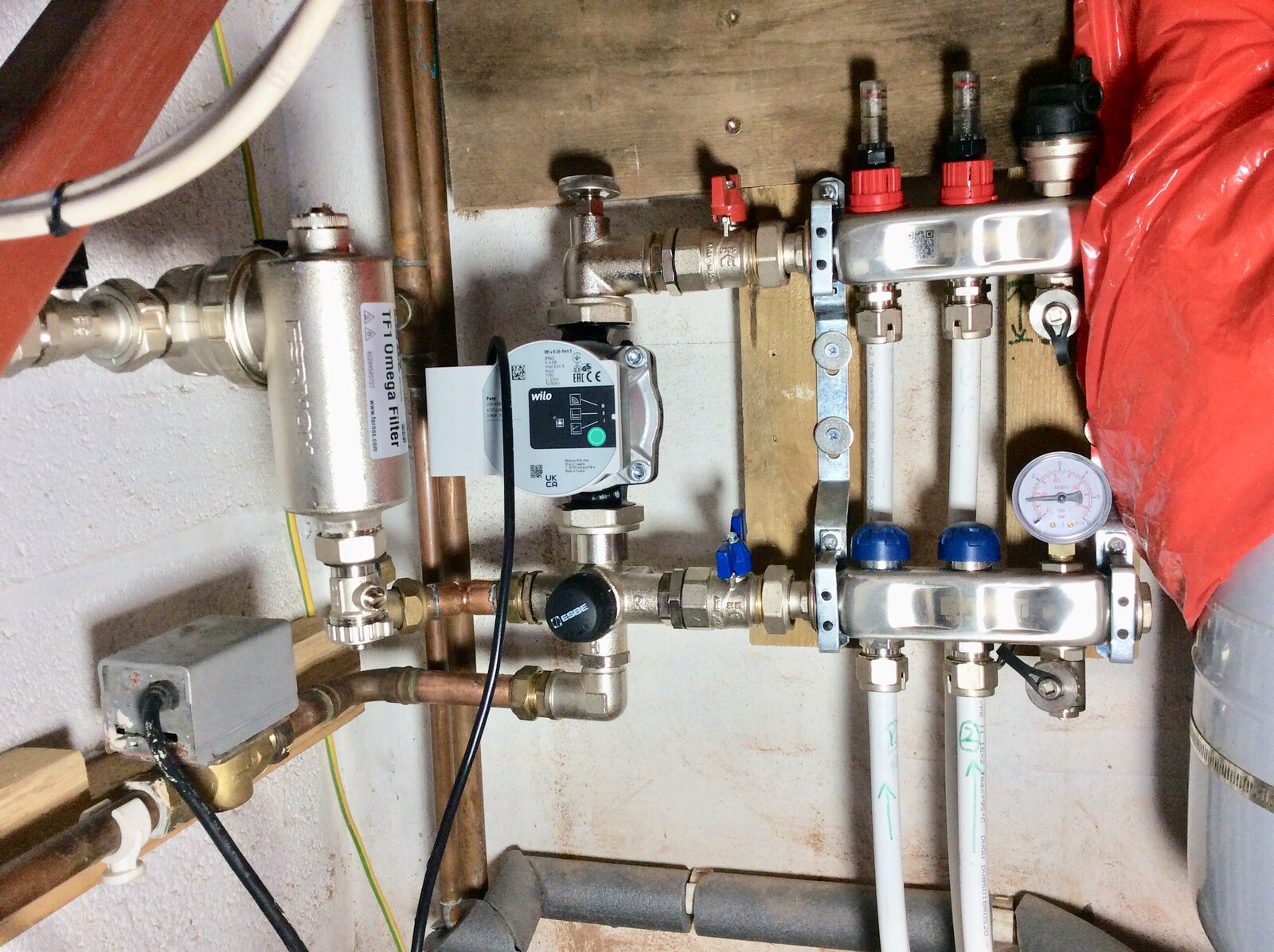

I put one of these on, also bought the adaptor for flushing the system
centerbrand one from plumbcentre about 70 quid , clone of Adey atom at over 100 quid
