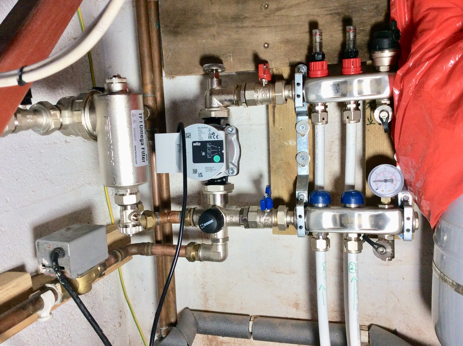

I only have experience of my TF1 Omega, but - Is there a different design of filter, where the magnet, is directly open to the system water?
With the TF1, you can unscrew and pull out the magnet, with the filter under pressure, and no water loss. On the rare occasion (now), when I check the filter - I simply switch the boiler off, pull the magnet, give it a minute or two for the tiny amount of magnetite to drop to the bottom of the filter, then release it via the flush valve at the base.

Harry, when you withdraw the magnet, it Will come out with some resistance exerted by the magnetic particles. You flush the can and then drop the magnet back into the socket. It should go in with no resistance unless the residual particles are stick to the other side of the socket.
Adey filter is taken apart and washed.
If the magnet was to be in contact with water, it would corrode. Happened one time on filter same as yours ( filter included in Ideal logic max boiler), socket had a leak in it wetting the magnet. By the time the replacement was sent by Ideal, magnet would not come out.
Thanks, got it now - I didn't have in mind a system with lots of corrosion/magnetite in it, because my own system has almost none at all.
