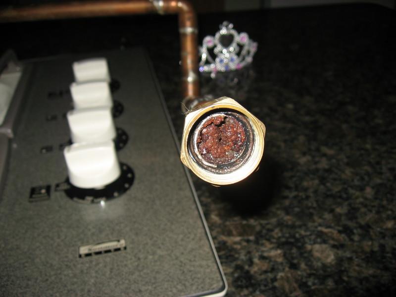

Well, how hot you keep your water has a direct effect on how much scaling/deposits occur in your system, just check out your tea kettle/coffee pot for confirmation. We just moved and purchased a home, could not figure out why the hot water pressure was so low. Investigated and found horrible deposits (photo attached) on the hot water tank outlet, cleaned, dropped water temp from 165F to about 135F, no more problems.
Oh... please disregard tiara in background...
