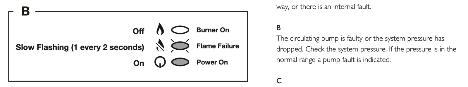

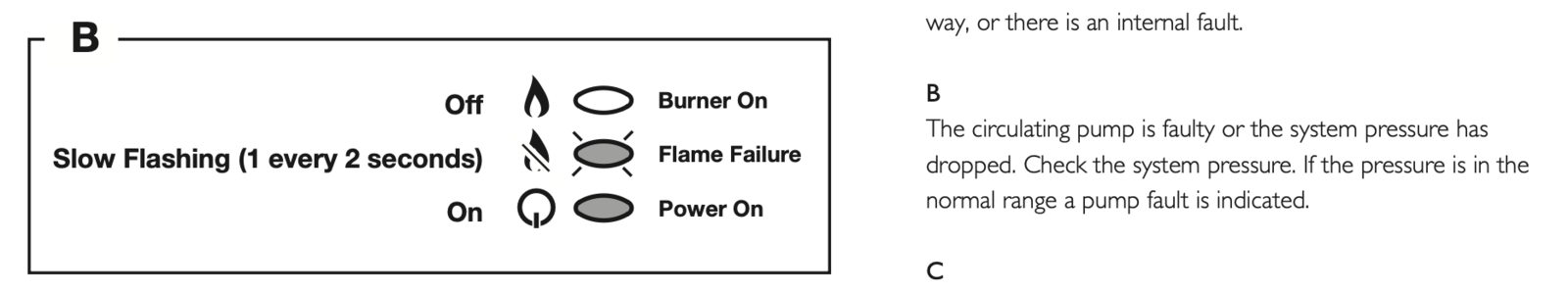

Hi @gas112 disconnecting the condensate trap wire doesn't make any difference.
The symptoms fit option B the best from the light fault troubleshooting.
