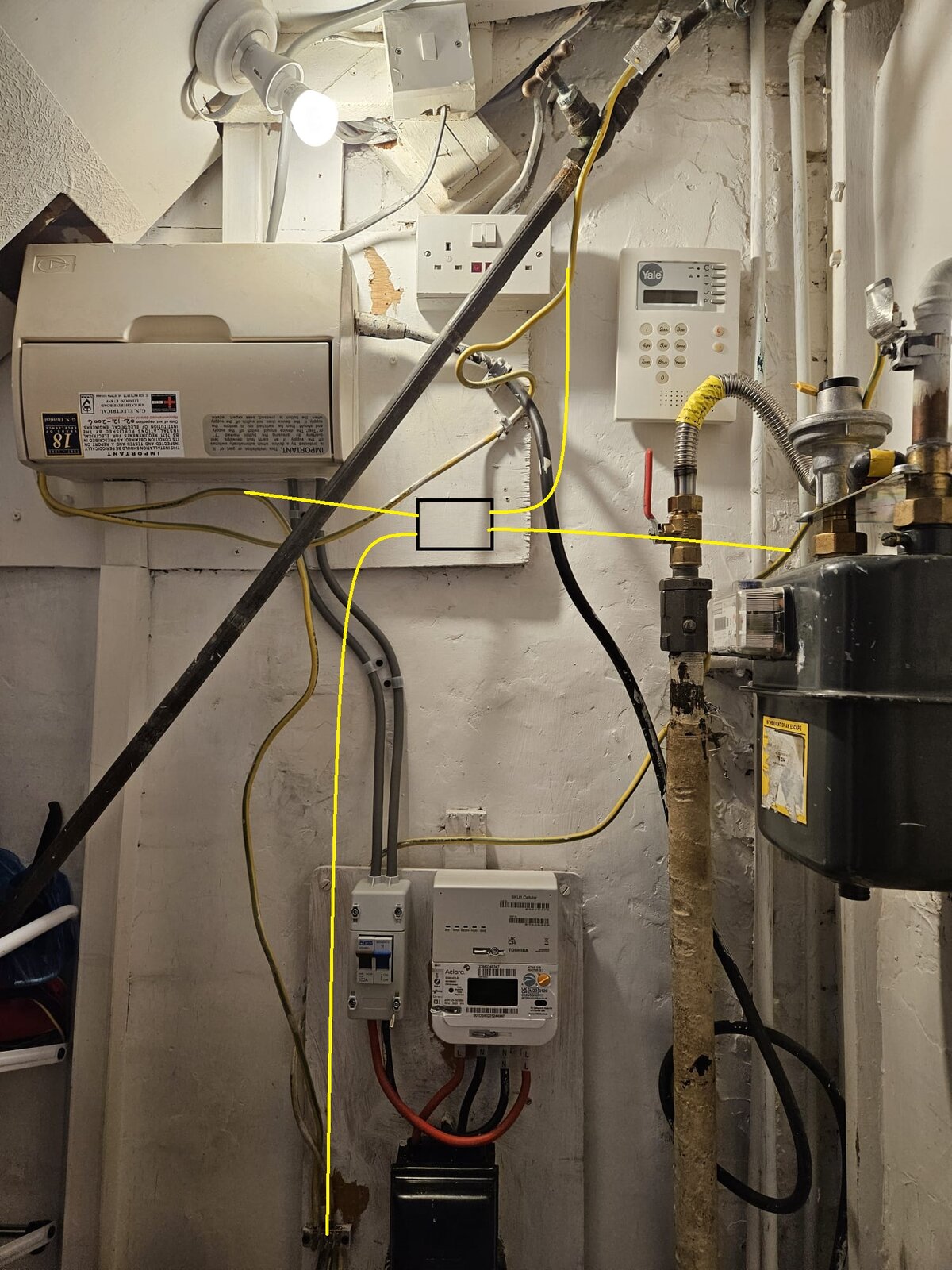

Just trying to tidy these earth cables as they seem to be all over the place and not very secure.
There is a 4 way earth block near the cutout that connects the main supply earth wire so thats where 2 wires in the picture feed down to.
Currently setup as following...
Gas pipe bonding cable going down to the earth block.
Mains water pipe earth bonding is fed to the consumer unit....not sure why.
Consumer unit earth cable connects to the earth block.

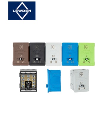

1. Can I fit a green 5 way block as shown in the picture. Feed the CU earth and both bonding cables and then take a wire from the block to the earth block below.
2. If thats not an option can I use a single earth cable to link the water and gap pipe and feed to the earth block.

That is a bit of a mess,
The main earth from the incoming supply must be 16mm and that could go to a new block, then on to the CU.
The equipotential bonding to the water needs to be 10mm, and can be 2 pieces of cable or 1 continuous going to the incoming gas and water
As long as everything is connected together, it doesn't really matter.

Appreciate your reply.
It was even more mess until I changed the old meter tails with new flexi tails.
Currently all the earth cables are 16mm. If the new block option is on the table i shall do that and leave the cables as 16mm

Just a minimal tidy up..some cables are extra long and hanging
Out of interest why are the labels upside down on the CU lid?
Any chance of a photo with the CU flap open?
I think the sparky must have attached the labels while the cover was off and got confused which side up.
It's appallingly bad!
Are the tails going through different holes or is it a stuffing gland? Is the Board Metal?
Actually it's more like pathetic. It was done 18 years ago. I was young and just bought the house and had the property gutted and rewired same time.
It's a plastic board with square knockouts so not possible to fit cable glands.
I suspect the board isn’t against the wall and all the cables enter through the rear
The board is against the wall...most of the cables enter at top and some at the bottom.
