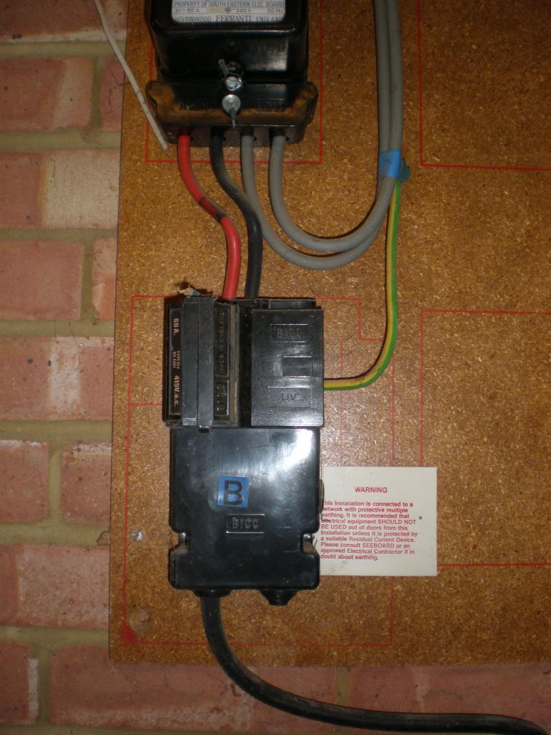

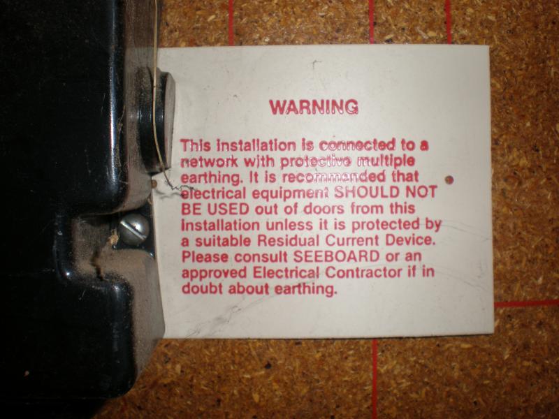

Protective Multiple earth notice - so TN-C-S?
Service Head
Main Cutout detail

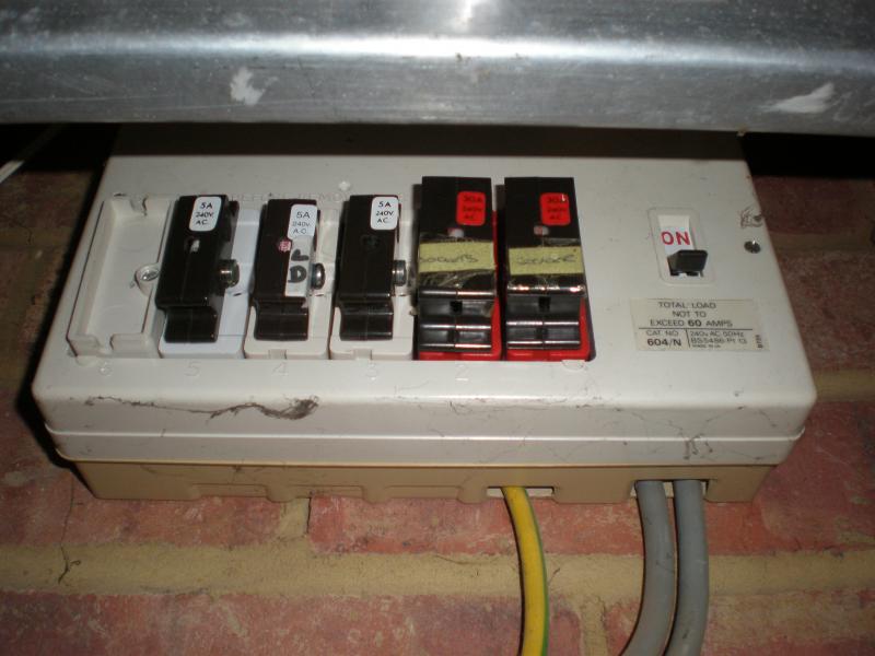

CU
Unused way, Fused unused. Downstairs Lighting, Upstairs Lighting, Sockets, Cooker
Incoming Gas bonding
Spoken to EDF who think the main Cutout is 60A because that's what it usually is!

I wouldn't worry too much about the service fuse rating, a 60A BS1361 will take a LONG time to blow at 100A

I think it's time for a CU upgrade too..
60A max load on that one..
RCD protection needed
