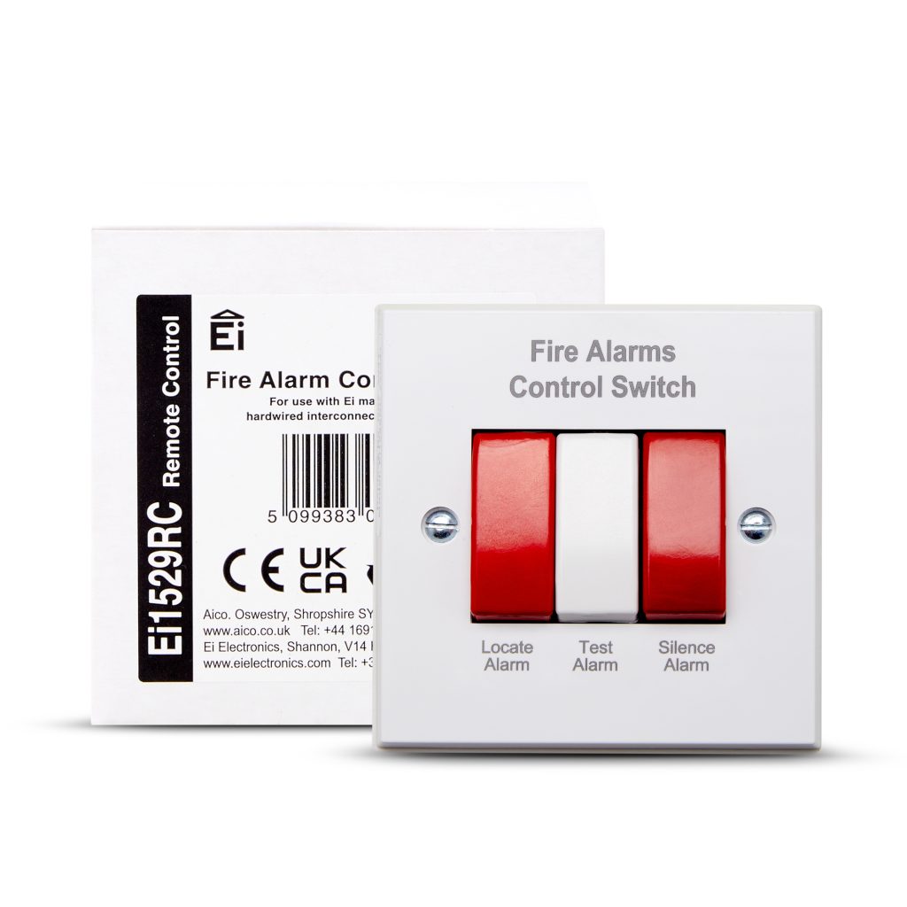

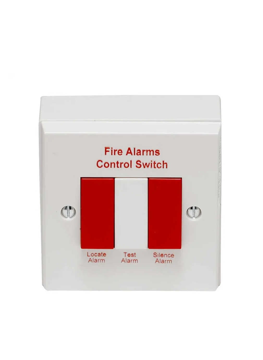

There is another issue, but which I don't think I can do much about. All the alarms will be ceiling-mounted and some, probably most, of the rooms will be over 3m high - so the alarms may well not be accessible using an average domestic step ladder, even for 'able' people. I presume that the alarms could be temporarily silenced/'hushed' by use of a broomstick or similar, but that wouldn't last long if the alarms were continuing to alarm/malfunction. I don't think there is any way of remotely (and 'permanently') 'killing' a whole (hard-wired') Aico system, is there?

I've never used one myself but here's the info.
Very many thanks. That's just what I need to address the 'high ceilings' issue but I've never found that - only a 'wireless' equivalent. I'll see where i can get one.
The wired version has less functionality compared to the wireless option.
Whether that is a problems depends on what functionality you require - but if going for the wireless remote control, you also need the alarms with a wireless interlink, NOT hardwired.

The wired version has less functionality compared to the wireless option. Whether that is a problems depends on what functionality you require - but if going for the wireless remote control, you also need the alarms with a wireless interlink, NOT hardwired.
Thanks. As I said, I had only been aware of the wireless version. However, my only real concerns were about problems of testing and 'silencing' due to the high ceilings, so the hard-wired version will be fine for me.
