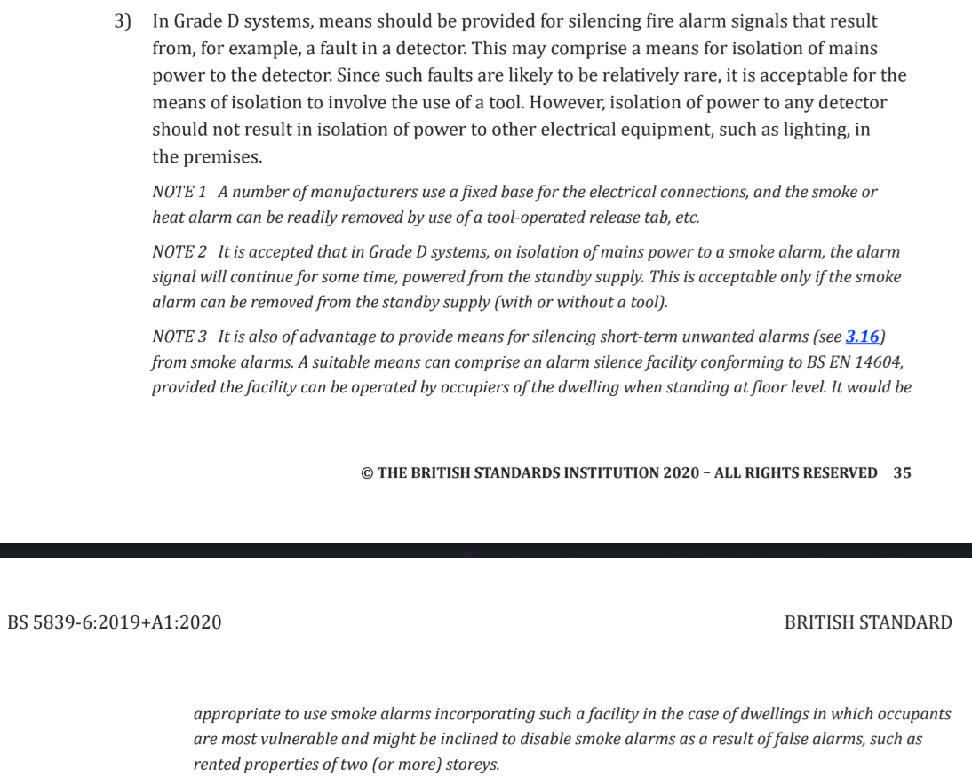

Isolation and remote silence facilities. BS5389-6
That's all very well, but it doesn't address (and one wouldn't expect it to address) the issue of the isolation that would be required if one needed to work on the fixed wiring supplying the base of an unpluggable alarm (which I have acknowledge to be such a rare event as to not warrant consideration) - so I'm not sure what point you are trying to make.

The Ei base meets the isolation requirement of BS 5839-6 where powered from a regularly used local lighting circuit.
I've already been through that with flameport.
BS 5839-6 is only interested in isolation of the alarm - and that can be archived by unflagging an Aico alarm from it's base. However, that's totally different from the need for isolation of the circuit if one wants to do work on the circuit - which, in addition to being a matter of common sense, is within the realm of BS 7671.
