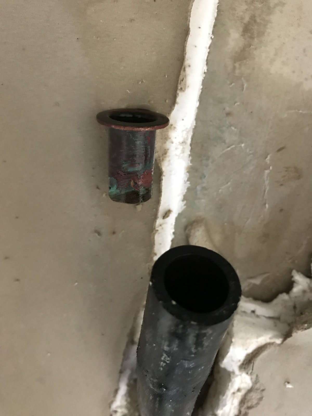

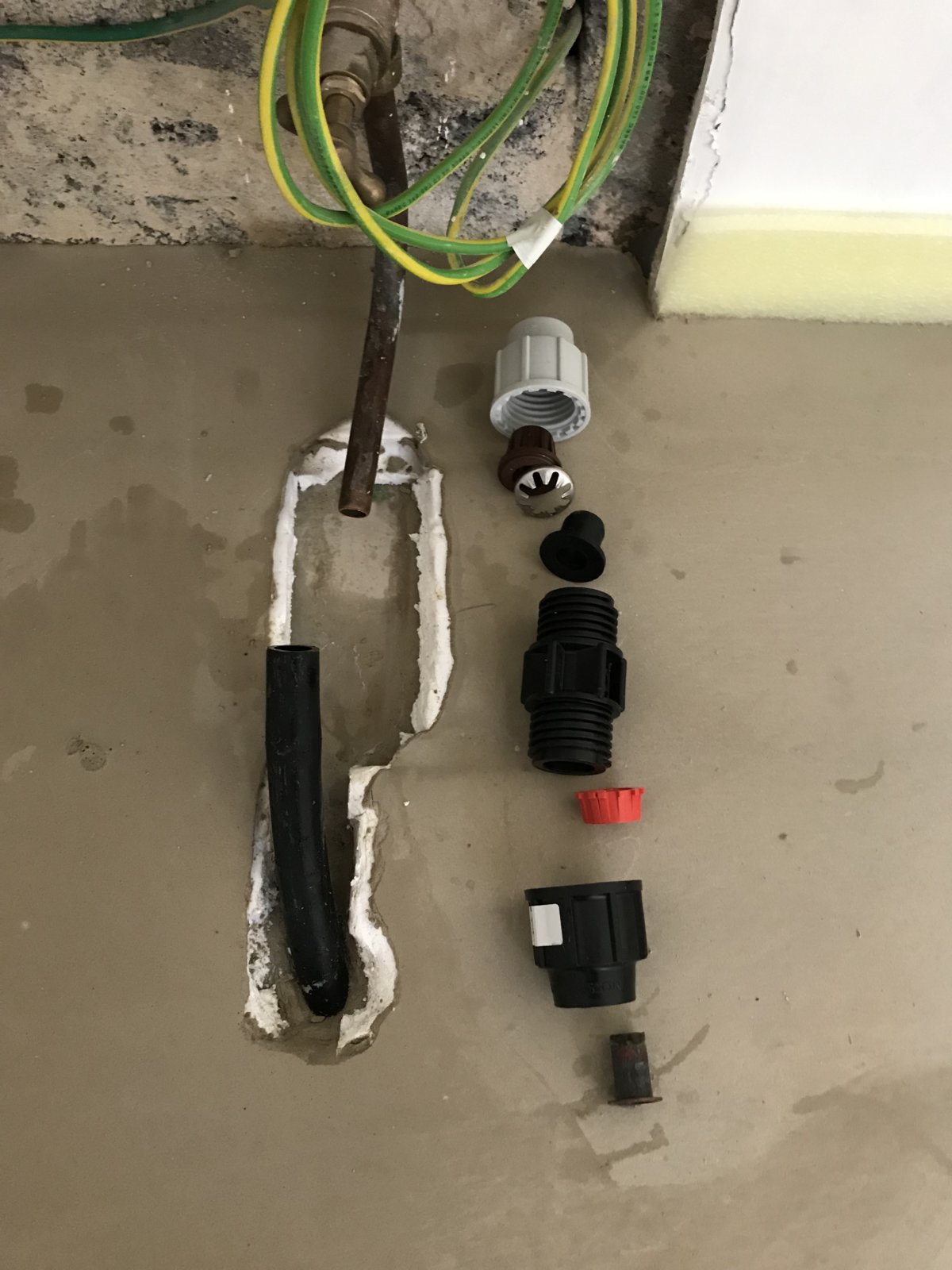

How does this look? All prepped up and ready to go? There was a pipe insert in the alkathene which I’m guessing I should stranger over to the plasson fitting?
Any tips with fitting it?

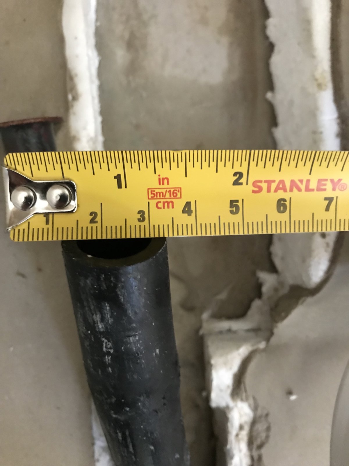

Also the photo shows it’s about 3-4mm thick alkathene.

That’s right, the black rubber pushed into the Plasson fitting.
I couldn’t get the pipe insert to go into the allathene so I’m guessing it only goes on with a brass fitting and you leave it off when using the plasson fitting?
I don’t fit inserts when I repair black alkathene.

Yeah. I was more worried that it was going to be screeded over for the UFH. As it's now been revealed that this area is not being built up and is under the plinth, then its not a massive concern.
And, my comment about mdpe included sheathing/wrapping it when installed because the existing alkathene is perhaps not!
