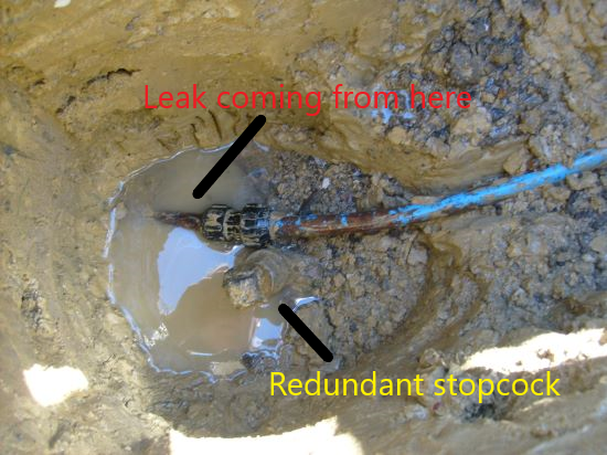

I had sprung a leak near to my boundary, although I thought it was outside my property, the water co. couldn't attend for a month, and my meter was running at near 700 litres a day. I decided to dig down to check, and found the leak was unfortunately a little on my side. Here are some images.....

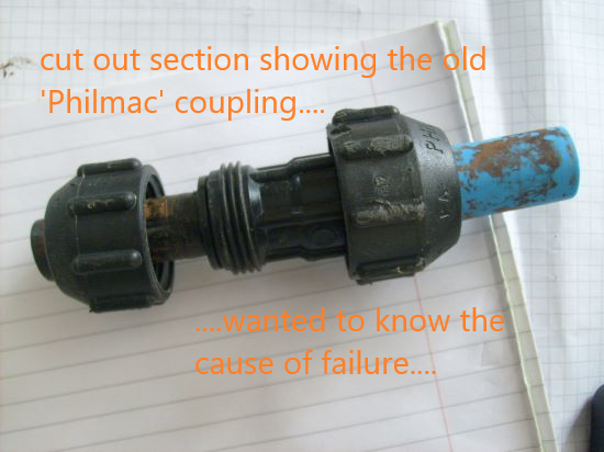

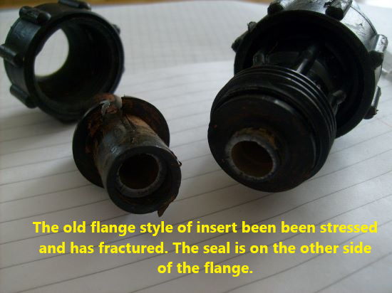

.... so the old 'Philmac' fitting although lasting about 15 years, doesn't have much 'give'. it was put in when the old stopcock was replaced and re-sited outside the boundary.

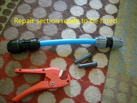

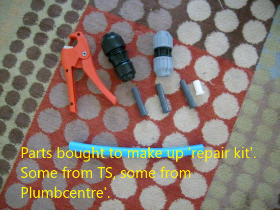

I could of just fitted the coupling, but at the time wasn't sure if the pipe had split, so made a repair section to be sure. The old supply pipe i have assumed to be imperial, since the house was built in 1968, but has an odd size of 17mm, which doesn't equate to any imperial size, it's about 2/3"....... but apparently imperial sizes do not need an insert. looking back i think i would've cut out the old insert to reuse in the black pipe, but too late now.
jobs been done about a month now and all seems good.
