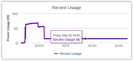

Well it did not take much to show fully charged

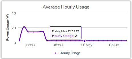

very quickly the charge rate dropped to 0.8 amp it took a little longer
to drop to 0.1 amp and it has remained at 0.1 amp showing 12.9 volt for quite some time, so it would seem less than 5 Ah to recharge the 95 Ah battery and the battery is only suppose to charge to 90% anyway.
As to how much sulphation has taken place of course can't tell, so will leave on 0.1 amp charge for the rest of the day, car will be used Tuesday so want enough time for battery to settle before use.

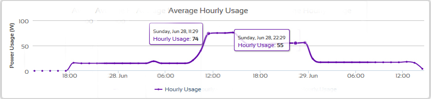

At long last caravan storage place has reopened, so been able to retrieve the battery, it was below 3.8 volts so charger just showed err, so put on motorcycle charge rate with a 7 Ah in parallel with the 90 Ah off the caravan to get it started, then 12 hours latter put on car to recharge.
Although it now shows charged, it is clear from graph that 90 Ah worth of charge has not gone in, average of 3 amp for 12 hours = 36 Ah and 0.8 amp for 24 hours call it 24 Ah so total is 60 Ah not 90 Ah. So it seems that 0.1 amp charge is still charging the battery, the voltage is dropping and once it hits 12.8 volts I will get a pulse of charge at 0.8 amps until at 14.4 volts then back to 0.1 amps again, from experience this is likely to happen for some time, as it puts in the last little bit.
So this is the question, how long after the charger shows fully charged which clearly would be enough if putting directly in a car in regular use, but where the battery is simply stored after it needs to be fully charged, yet with around 8 batteries to maintain, simply leaving it on 24/7 is not an option either. I need to swap the charger to next battery at some point.
I have noted the AGM batteries tend to hold their charge longer, so even after 6 months sitting in garage, maybe longer, it recharged very quickly. So some batteries need charging once a month, others once every 3 months. But it is how long after the charger shows charge complete do you wait before moving charger.
I must apologise, turns out battery is only 75 Ah not 90 Ah as thought, so seems it has fully recharged.
