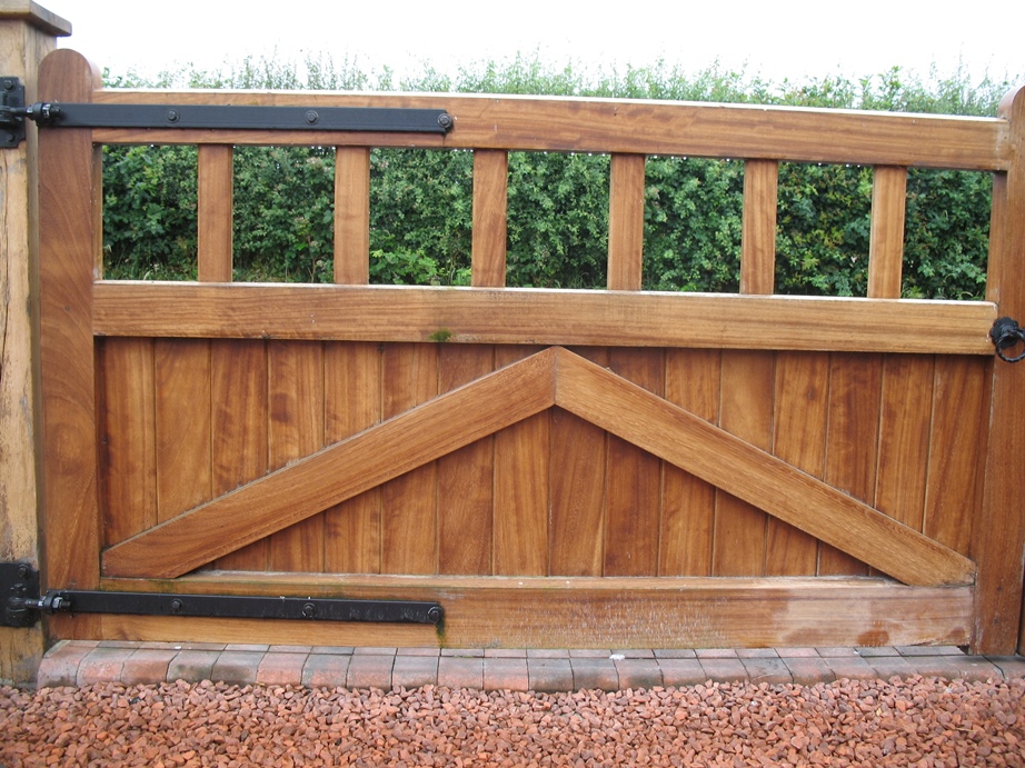

in my opinion, it would need planing to get back to bare wood.
Don't even consider taking a plane to it. It'll do far more harm than good. Just work at it with the sander. Personally wouldn't go overboard with it. Just do 'enough' then treat it repeatedly for a while.
What Osmo stain was used on it - generally speaking if you're using a lighter coloured stain it has a lower UV SPF.
What you're seeing is where the water repellency has worn off and the UV rays have started to break down the wood. As per my previous you should try the OSMO wood reviver gel http://www.osmouk.com/sitechaptern.cfm?bookid=Products&chapter=82&page=270 - this should then allow you to blend in some more osmo on the unprotected areas, then sand the (whole) gates lightly with 120 grit on a Random Orbit sander and re-coat with OSMO, if you opt for a low UV rating oil then finish off with a coat of their UV protection oil. In future you should then just need to give it a coat of the UV oil periodically.

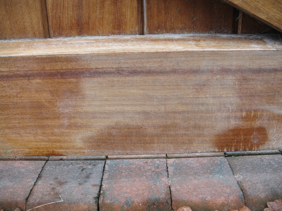

UPDATE.
Please see the photos. below to see what happened when I tried the sanders. The lightest area is where I used the belt sander but I did have to dwell for about 5-6 seconds just on that one place to achieve that result. The area underneath that shows where I used the orbital sander with an 80 grit pad and I also used the mouse sander on it with a new 80 grit pad. There is no way of taking every part of the gates back to bare wood. Some parts of the joinery are quite intricate and are only accessible using the mouse sander.

Osmo UV Protection Oil was used after they were made 2 years ago and also when they went back to the joinery shop 12 months ago. This was the stuff but now I see that the word "Extra" has been added. http://www.wood-finishes-direct.com/product/osmo-uv-protection-oil Was this the wrong material to use on the gates ?
In my mind if it is an oil or a hybrid of sorts, you do not need (or will be unable, as you have found) to remove it all. You just need to give the surface a light sand all over then apply a new coat(s) of oil. I would certainly apply more than one. This will end up blending old and new. but you need a consistent sand. I would avoid the belt sander, they can be far too powerful (you are meant to move them constantly). A small random orbit sander at the most.
I think a decent hand sanding pad should be fine. Start with a low grit, and finish with a high grit. Then start to re-apply coats. Whether you go for another oil or stick with Osmo is up to you. It should not affect it too much.
Try a test area. I would just do it on that bottom support (where you have sanded already). Try and sand the rest of it to the same/similar colour. Then re-apply a few coats. Use it as a test area. If it works, use the same method for the rest of the gate. Just use a hand sander though and sand less.

No that isn't the wrong stuff but in your case it looks like it's lost it's water repellent effect so needed reapplying before it 'silvered' - as the wood has silvered you need to restore the colour so as per my previous post I would use the Osmo gel reviver which is an oxalic acid based product on the weathered areas, then lightly sand all the gate and then reapply the oil - you may need to do an extra coat in the weathered areas.
