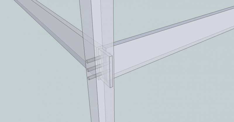

Not sure what furniture connector bolts are. Do you mean doing something like this, so connect the legs with the side rails?

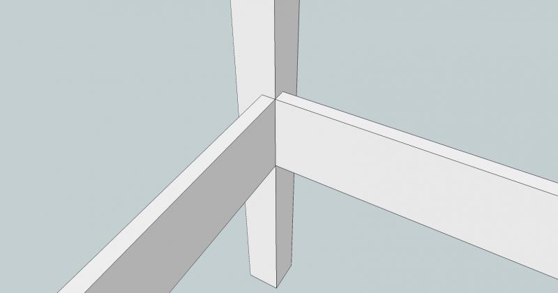

If I post up the final design tonight which is well under £100, will you guys be able to tell me the best way to connect the legs to the side rails? I am not too sure I will be able to use furniture bolts. I know where to get the bolts from which will need to be around 125mm, but I don't think I will be able to drill straight wholes into the side rails and lets that long.
in my design you simply screw through the sides into the legs with 2" screws countersunk 4 from top to bottom slightly staggerd and the head and foot you screw into the legs with 3 screws between the ones on the side

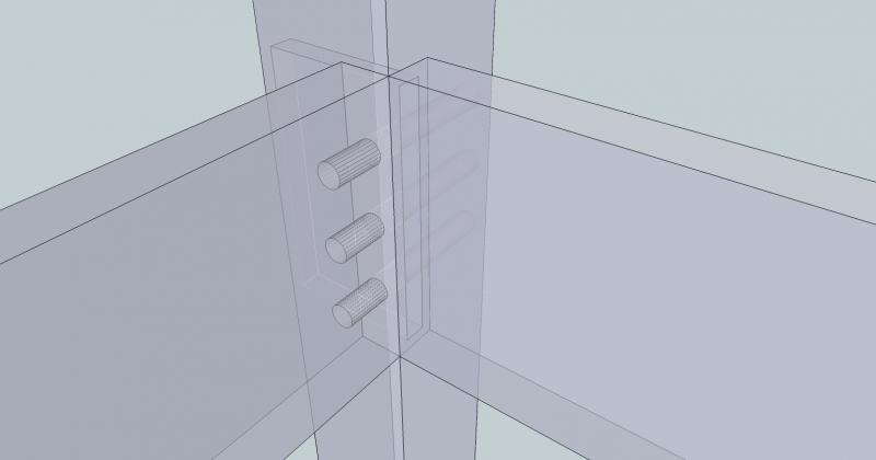

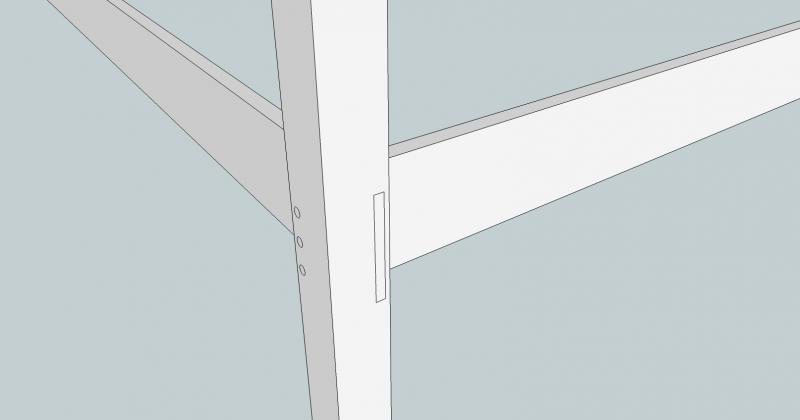

Is this a strong way to join a post (leg) with the side railing and the foot railing?
The side railing has a 3" tenon which is half an inch thick, and the foot railing has 3 half inch drill holes into which I insert 4" wooden dowels which go through the leg, the tenon and into the foot post.
Or will this be weak?
