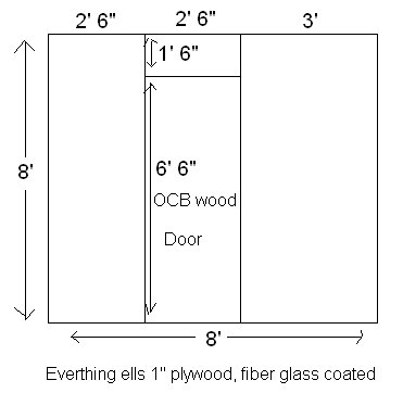

I have done my door and wall diagram of two of the doors and wall that I need. What do you think? Do you think it will work or not?

That or you might want to consider a surface mounted type of hinge instead
Short sided door hinge, but only if the plywood and door are not heavily enough framed to be able to use butt hinges or similar

In the diagram above; I plan to use the 1" thick fiberglass spayed ply wood. For some reason this is indeed very heavy stuff. But also in that diagram I propped to us 9mm OSB boards as doors, so not very heavy or strong
What is a Butt hinge?
Surely you will need to add a stiffening reinforcement found the edges

Yes. It was me. The issue isn't the type of wood - it is the structure of the material. Put simply, wood screws are designed to hold when driven into the face of materials like timber, plywood, chipboard, etc. They have very poor holding ability when driven into end grain of timber or edges of man made boards. This is why you need to either use a hinge similar to the type I posted above, or you need to add some form of framing (such as, say, 2 x 2in softwood) to the backs of the doors which can be used to carry the hinges

Your choice. I've seen these used with wood screws on boats and in caravans, and countersunk head machine screws on metal vehicle bodies. There is also a version designed to be installed using rivets (although notcreally suitsble for used on timber IMHO) . Coach bolts obviously won't fit into a countersunk hole, so would be a poor choice

WTF? I can hardly think of a worse material than OSB (I presume that's what you mean - Oriented Strand Board) to make up doors. Thin OSB would really need to be on some sort of (softwood) framing and on its' own is too thin to hold screws which will carry hinges, etc. It needs some sort of frame

Ask yourself a question; how am I going to fix hinges and locks to the material I intend to use? OSB is a poor choice unless it is on some sort of frame. Trust me, I'm a chippy. And maybe do some experimentation of your own, too

If you make your doors out of 9mm OSB, and bolt the hinges in place, it will look like cr@p. The edges of OSB are really rough, because that is the nature of OSB. All this makes me wonder if you have even seen OSB
The solution is probably to frame the door openings with softwood - 2 x 2in or even 2 x 1in edge on because you really need to stiffen the door opening (have a look at some mobile homes or static caravans to see how they do it). You seemingly haven't figured out how you are going to fix the plywood vertically, yet, and without doing that I can't see any way to progress
