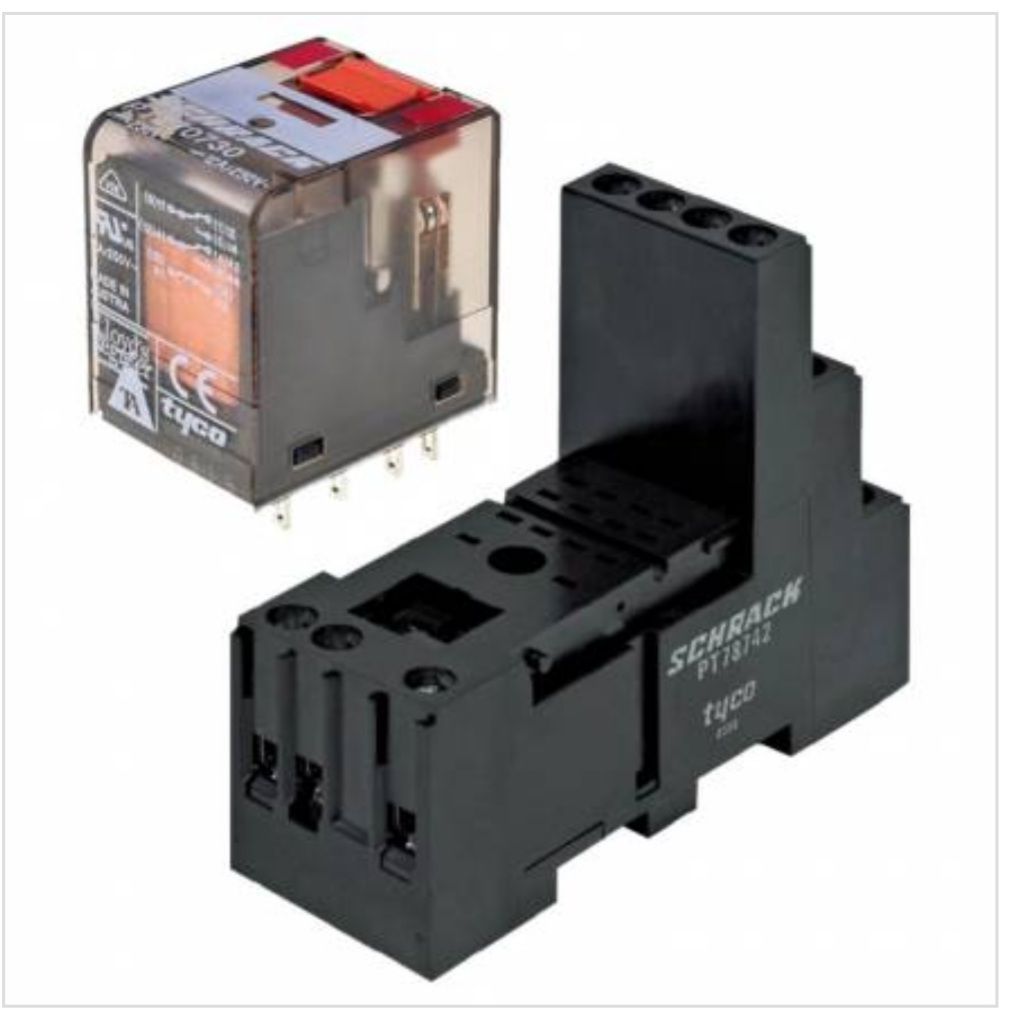

The cooker company gave me this as a substitute to the one fitted.

The "Rockwell" relay thats fitted seems very uncommon these days. I did find a very similar one that was £130 for one!
As posters were confused about the pins. They are spades in a grid formation.

The original is actually RS badged one of these: https://www.ebay.co.uk/itm/20460210...MQvrhmiKKzamBA2WmvnY-3po7jsRYfjkaAu4UEALw_wcB
No longer listed but speaking with a colleague a 2002 paper catalogue confirms it is a 240Vac 6.6mA coil with 240Vac 10A contacts to this pinout: Different to Frodo's unusual suggestion
Terminals 1 and 2 are for the Normally Closed contacts (and are not used.)
Terminals 3 and 4 are for the Normally Open Contacts.
Terminals 5 and 6 are for the Commons.
Terminals 7 and 8 are for the Coil
It is still a 'standard' style and freely available, 4 options, all ready to plug straight in:

Will this swap out my relay without alterations?

Those 4 relays I provided links to are described as the same format as the one in your pictures, any of them should plug straight into the existing socket.
However excuse me for asking but have you proved it to be a relay fault?
The reason I ask again is the 'dropping out during service' you mention is more usually indicative of a fault elsewhere.
