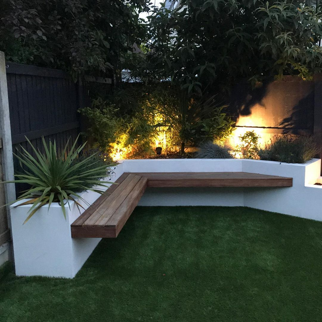

Manhole under fence and under raised planter
Is the bench fixed down?
It's one of those floating ones. Bit like this

Not sure where you got the assumption we've not even taken the top off from.
We took the top off when we exposed it. There's only 1 pipe in it, which comes from our soil stack out of the kitchen. Turn on kitchen tap, water flows to manhole outside kitchen window, down to this manhole, which then changes direction down the side of the house.
Build a section of planter on heavy castors then it can be wheeled away for access, cement board painted can mimic rendered wall and lightweight enough for construction of planter.
