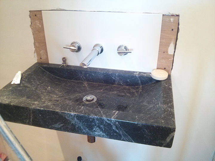

Hi,
I have just installed an expensive end of line marble sink from a major high end marble and stone supplier.
Sink looks good, BUT, it doesn't drain properly.
It has a wide flat bottom that has no camber and therefore it won't fully empty and leaves a considerable amount of water.
I asked why it was end of line. They claimed too many arrived with damage from Turkey. My view is perhaps they were causing too many complaints and returns....
I haven't as yet complained and need to be certain that I have a sound basis.
My point is that sink should drain by definition once the plug is removed.
Any thoughts and observations really appreciated.

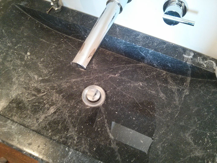

Yes I have installed it properly-which was a major task as it is suspended on metal rods, sunk into inner and outer walls-worked with technical at Rawplug to obtain best solution. The sink is flat and drains in the centre-unlike a Belfast sink which drains in the corner and has a built in camber. Please see images.
Can you not introduce a shim between wall and basin to jack up the front of the basin a mm or two?
You would expect a top end fixture to have the rim and bed to be in total alignment if bed is to be flat (nil slope to waste outlet). Having said that, a flat bed on a basin will tend to have standing residual water across the entire bed as water finds its own level. My understanding so do not shoot the messenger
Flat bed will not drain is my belief. How can it? Shower trays etc have slight degree of fall and are designed to drain. Dy definition (sort of) a sink should drain. You don't expect to have to mop up after use!

Some suggestions:
1. Make sure the top of the basin truly level, side to side at front and back, back to front at each side.
2. Try and shim it, as suggested by DP, to see if that improves it.
3. Is the waste fitting slightly higher than the inside base of the basin. If so, the water will never drain. Try changing waste for a flush one, or grind out waste hole to allow it to go in deeper.
4. Consider getting a stone masons / marble workshop to grind in a fall front to back, blending in to the sides, then re-polish.

1.Yes all level..flex of rods slightly forward but can easily correct and have supported it to text flow and no difference. If its flat it won't.
2. Shim it-not sure what you mean in this respect?
3. yes, agreed re waste BUT it should drain all except tiny bit round waste. The waste rubber was deep and dense-sealed well but with impact being slightly risen. Can swap with thinner washer which I have but can't see that it will rectify pooling effect.
4. Given what I have paid for it I shouldn't have to expect to take it down and go to a stone masons should I?! Hassle, expense. I have fitted quite a few sinks and never had a problem like this.

Thanks again. I think a seller like this one which i a very expensive and large one would care about the standard of their products and have consequently withdrawn these sinks. The question I am asking myself and others is a sink unfit for purpose, as you rightly say, if it doesn't adequately empty. Adjusting the height of the plug/waste will not drain out large pool of excess water-only small area around plug. That isn't really the issue.

Thanks. I know marble doesn't like acids etc. My feeling though is that the small amount round the plug isn't the concern. Its the larger pool that 'sits' in the sink that doesn't even get near to the waste hole. I may go to the shop tomorrow and ask a few questions....
