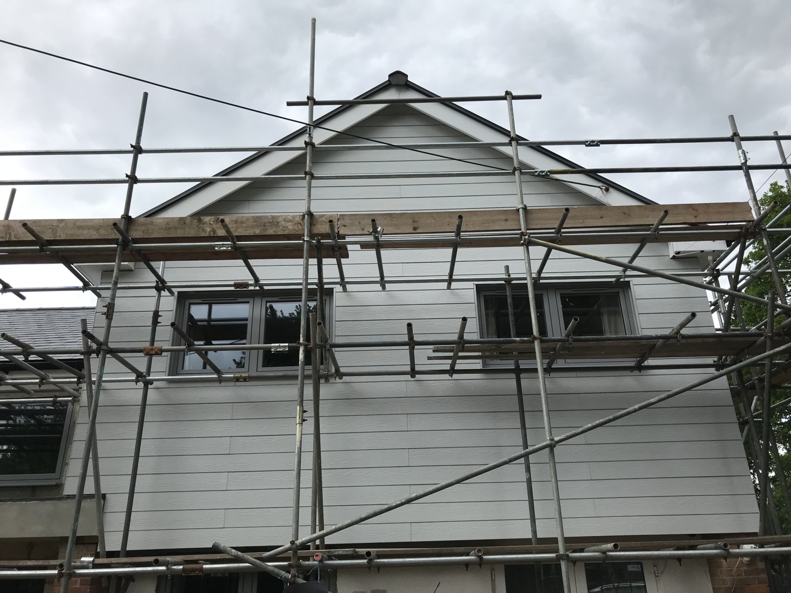

Hi,

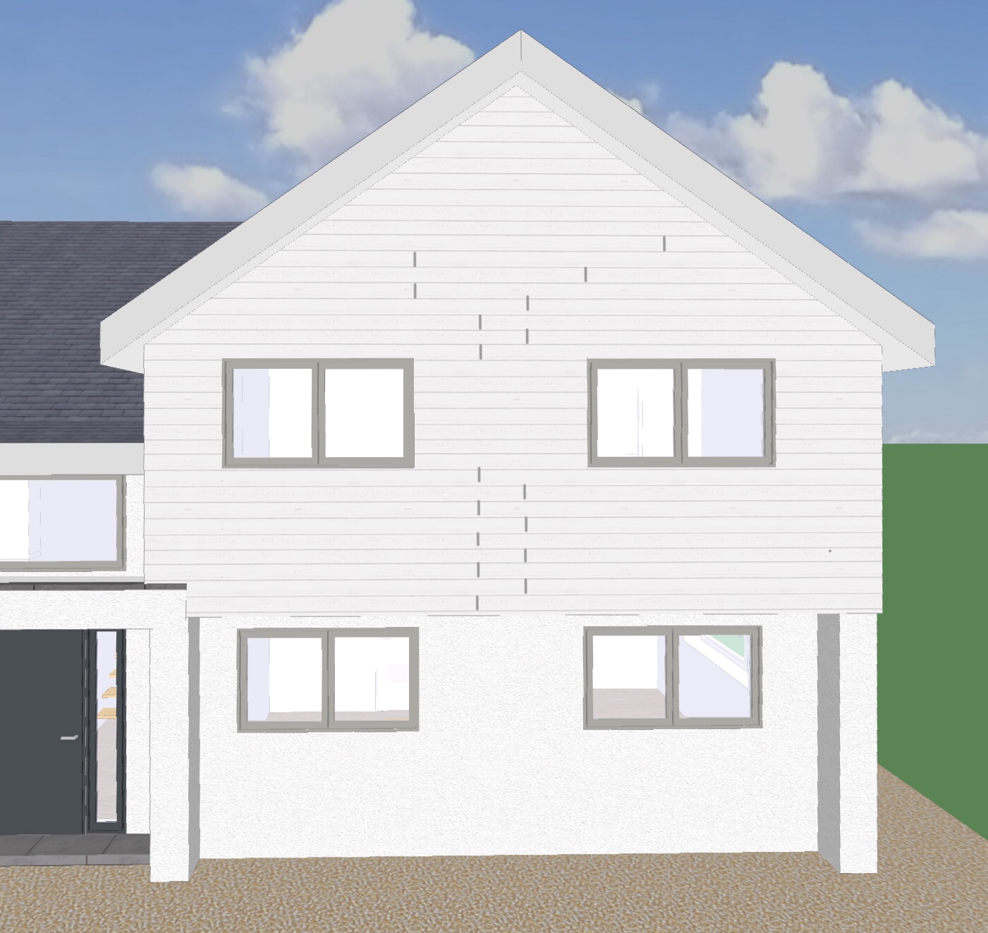

Just reading this thread with interest as I’m about to install Cedral Click on the front gable of my house. Does any one have any top tips or things to watch out for.
In particular the jointing pattern. I’m not sure how visible the joints will be. I’m thinking I should avoid lined up joints but I’m wondering what the best way of doing it would be.
Any advice from anyone?
Thanks.
Ps.
Here it is. I having C51 Silver Grey Click from the first floor up. Front only, not wrapped around the sides.
Will look something like this:

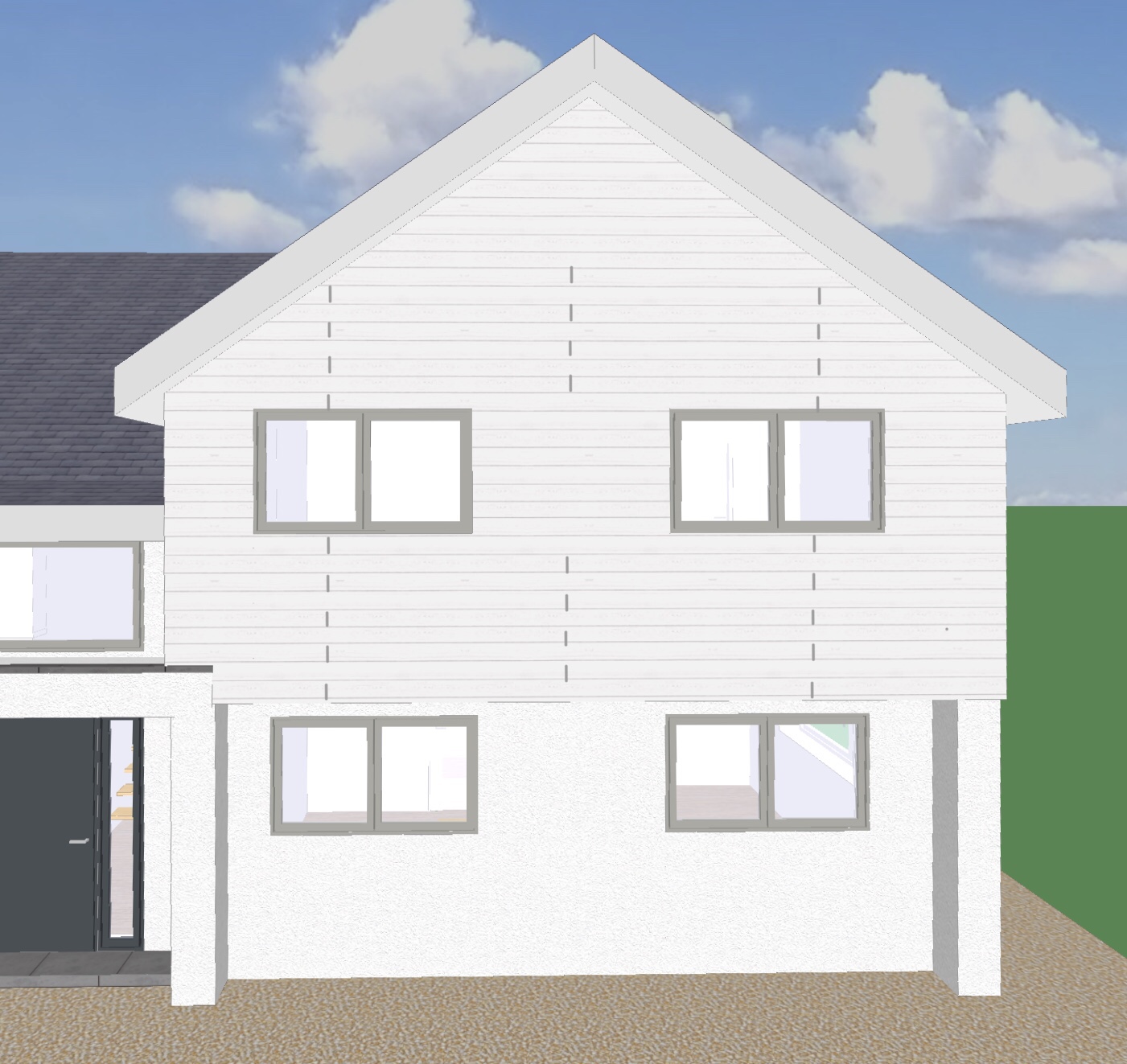

With the jointing is random best or more regular like below. The max width of the wall is 6.8m and the planks are 3.6m.

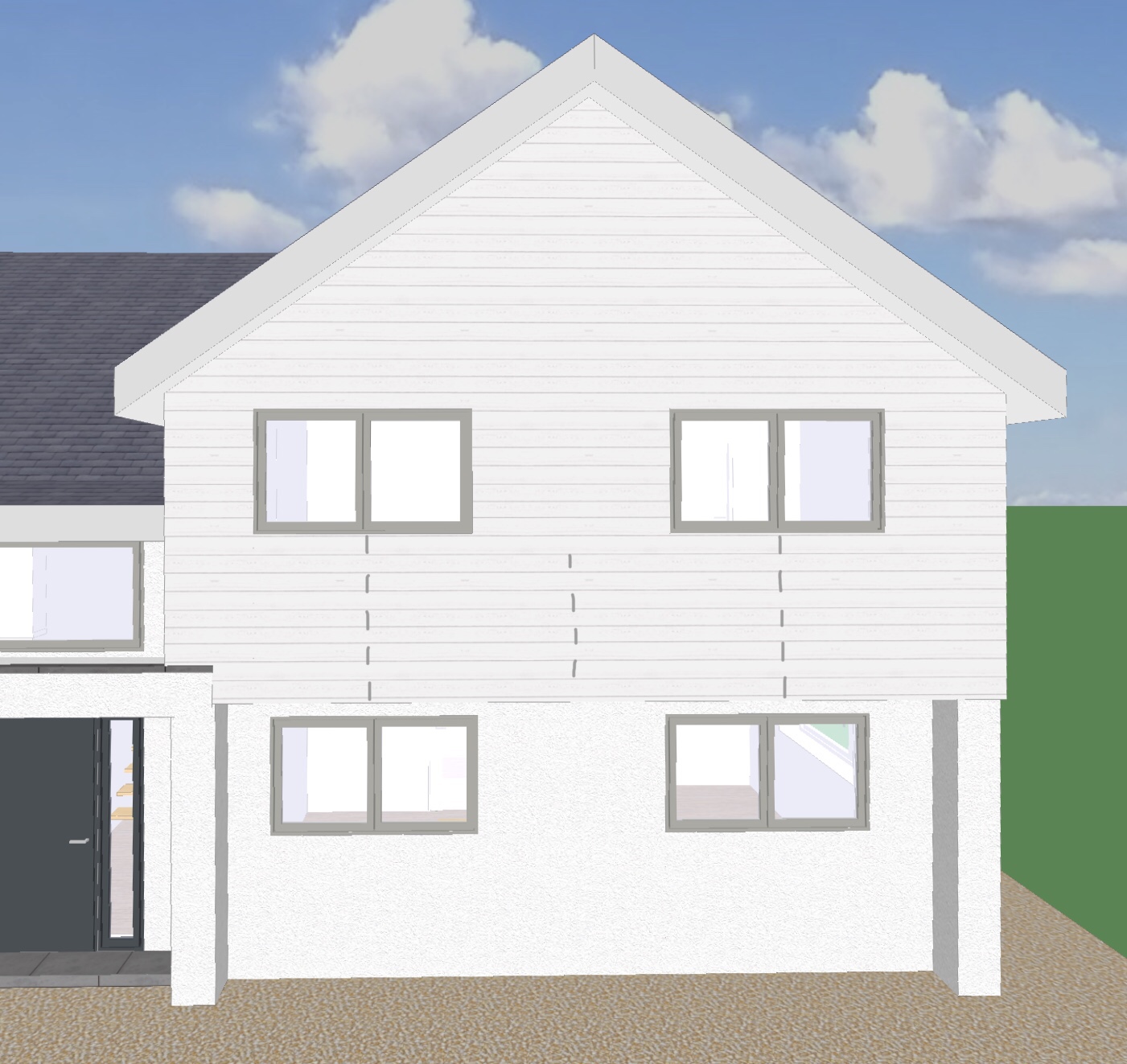

Or is it best just to make as few cuts as possible as the joints are hard to see anyway and must end up on battens like this:
Thanks.
Makes more sense. After measuring, I think it’ll look something like this:
Here is the finished product (well almost):
I’ve the done the rear and side of the house as well.
Thanks for the advice!
