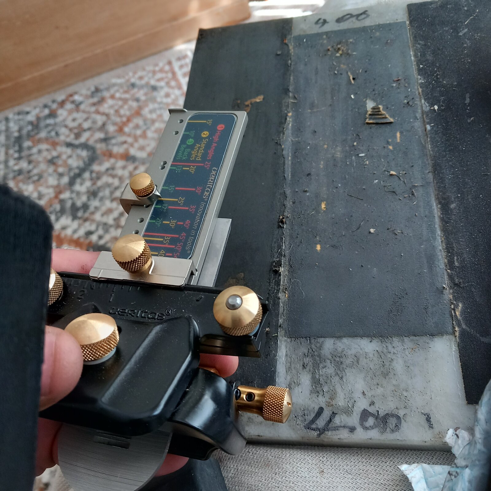

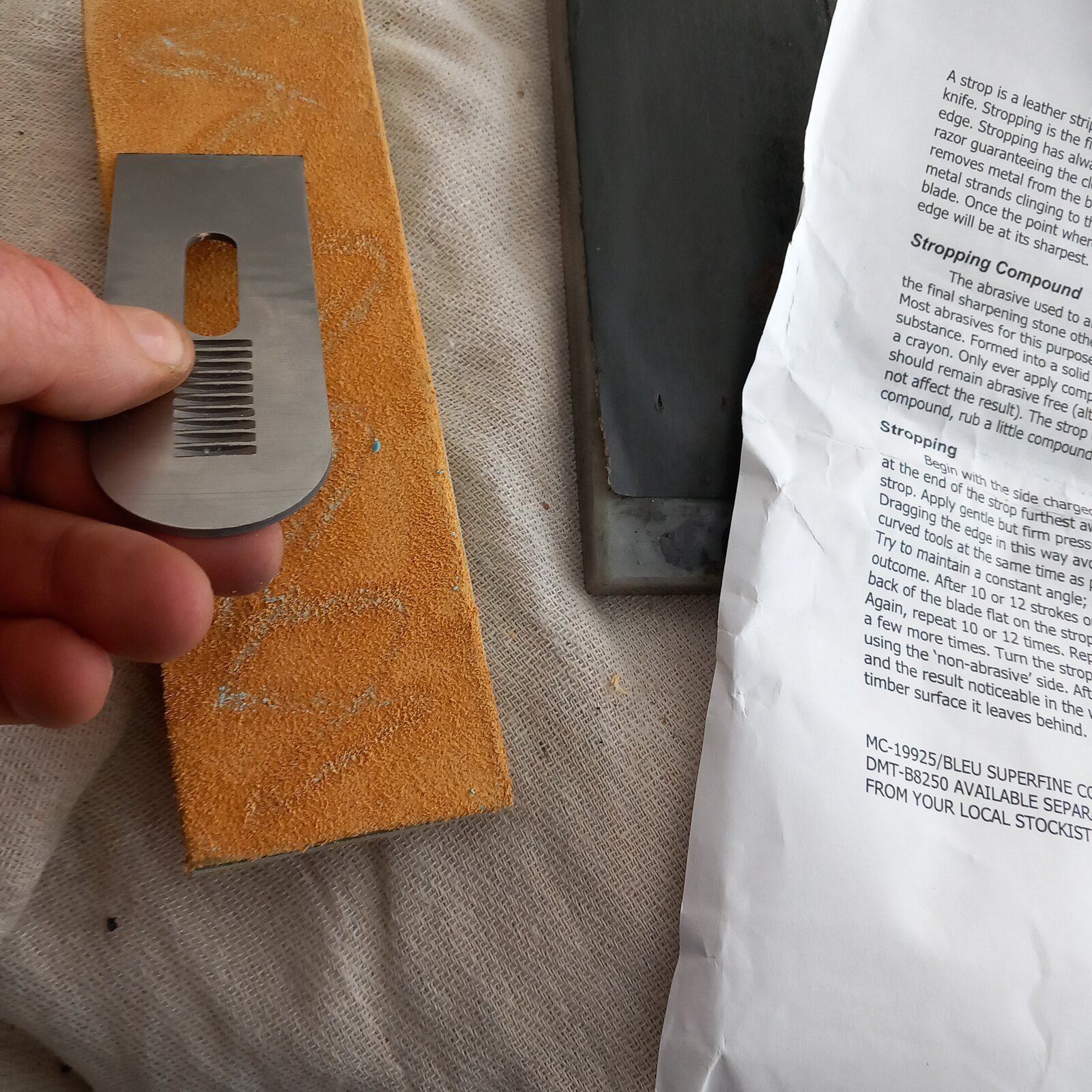

Been practicing on a cheap block plane blade from b and q. First tried to flatten back doing circular motion on 320, 400 then 600 wet and dry then polished on Waterstone 1000 then 6000. Still some small scratches and seems to take ages. Dunno if took enough off then onto secondary bevel using Veritas jig. Amazing piece of kit through the same wet and dry then onto Waterstone. Then bought a strop, dragged the beveled end with wax on strop ten times then flat side then strop turned over and same again.

Can you strop and not hone an edge throughout the day to keep it sharp? (Someone told me this.)
IMO yes, people oversharpen chisels, a few strokes is sufficient, sometimes flattening the back is enough

The chisels are pre ground to 25 degrees, which is the first bevel, you now need to introduce a secondary bevel or the cutting edge, the secondary bevel is formed at 30 degrees, for this you will need a honing guide.
There are many honing guides on the Market. Veritas make a very good Honing Guide about £70.
You could buy an Oil Stone for cutting the cutting edge, I prefer Whet Stones, I have 3000, 4000, 5000, 6000 grit, Whet Stones sharpen faster than Oil Stones.
Remember the back of the chisel, this needs to be flattened along with sharpening the secondary bevel.

You could also buy a leather strop if you want deathly sharp chisels.

I bought the veritas guide. On my plane blade set to 25 degrees but adjusted knob on bottom right to six o'clock secondary bevel. Do you do the same for chisels?
