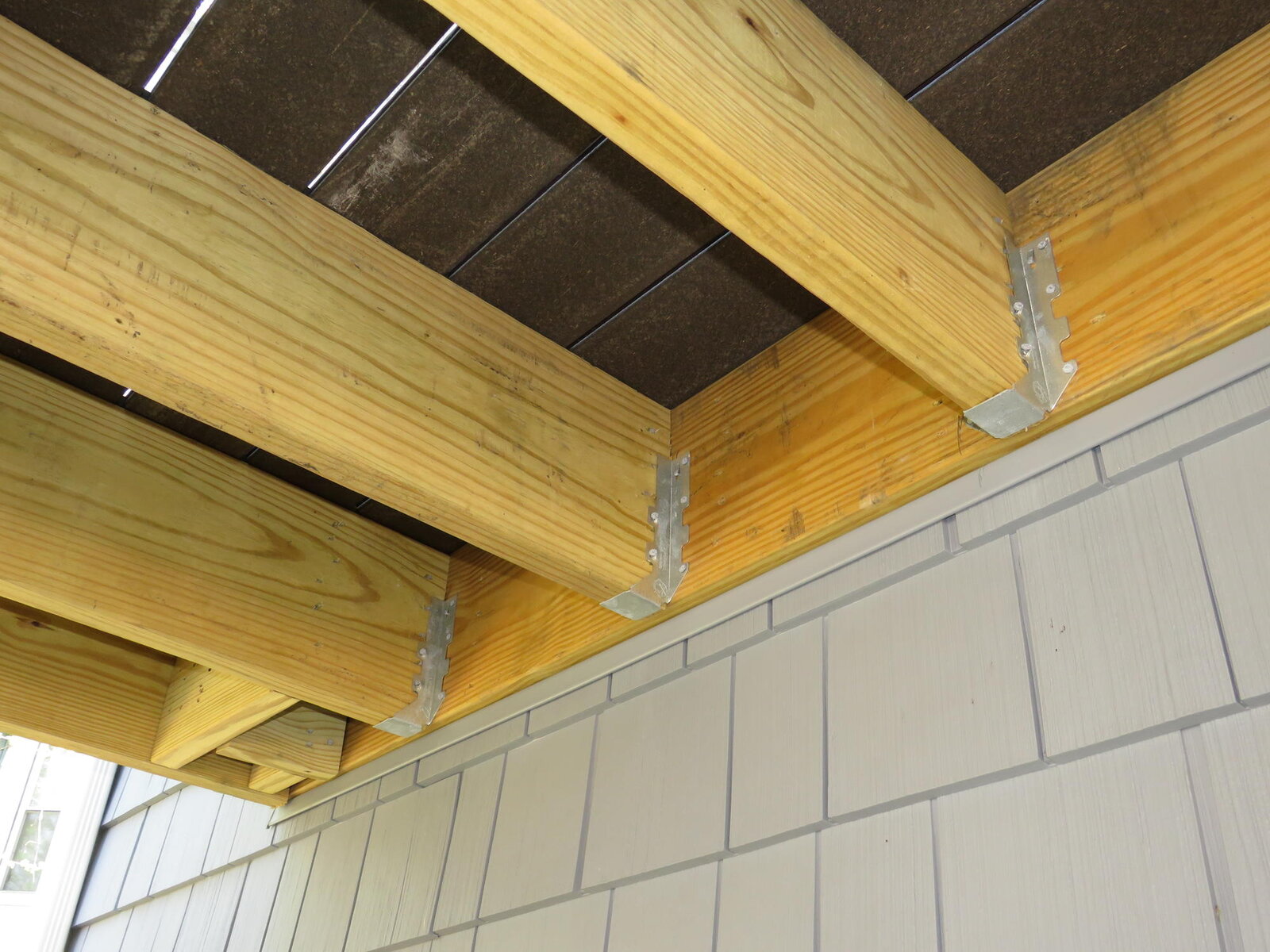

For my loft project I was going to cut out holes in the walls and install 8x2 joists to sit in the walls, I don't think I can do that and have decided to use 8x2 masonry hangers instead. The problem is how to do so? The walls are already up so how do i cut the bricks, get the hangers in and then drill and/or use bolts to secure them to the brick, I am a little confused. Can I use a circular saw and cut a line in the bricks and push the hangers in? If I was to do this would the hangers hold the joists?
Is there an easier way to do this? Do strong hangers exist which can be drilled into the brick and then hold 8x2 joists?

Generally, it is easier to install a ledger beam on the wall and then install the joist hangers on that
You can do this solo if you can lift the beam yoirself; drill a hole near each end such that you can leave a screw poking out the wall, sit the beam on the screws, drill through the beam at whatever regular interval you've chosen and screw it to the wall proper, then remove the two temporary support screws
Install joist hangers with square twist nails to the holing spec required by the hanger and then sit the joists in

A ledger beam is easier, but if you want to use retrofitted masonry joist hangers then yes:
cut a slot,
clean out with brush & air,
fill with mortar
push in joist hanger
There's no structural difference in a retrofitted hanger and one laid in the bed course... so long as the mortar bond is good.
But cutting 15 slots is harder work than a ledger beam in my opinion.

Normally resin anchors are specified, this is because old masonry is less reliable when using mechanical anchors. It is unlikely that any sort of plug & screw fixing would give enough capacity.
The anchor size and spacing is dependent on the span and use of the floor, so it may need to be specified by an engineer.

The easier way may well be to drill in a beam to bith walls and hang the joists off them.
