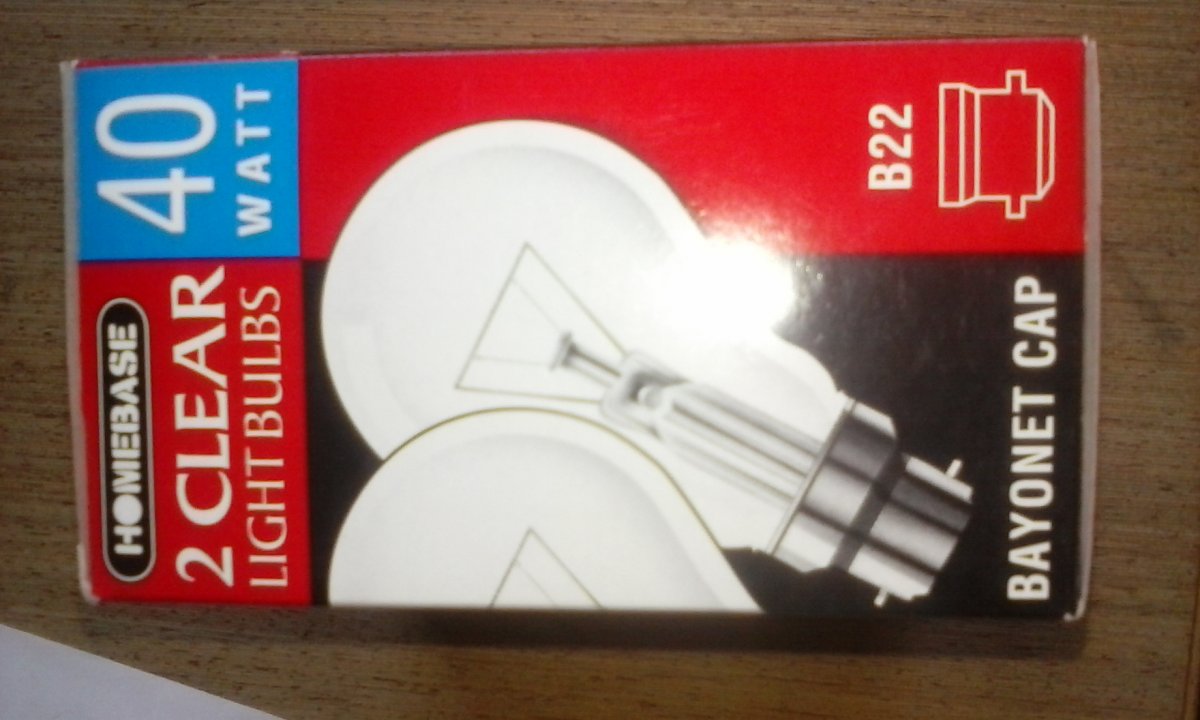

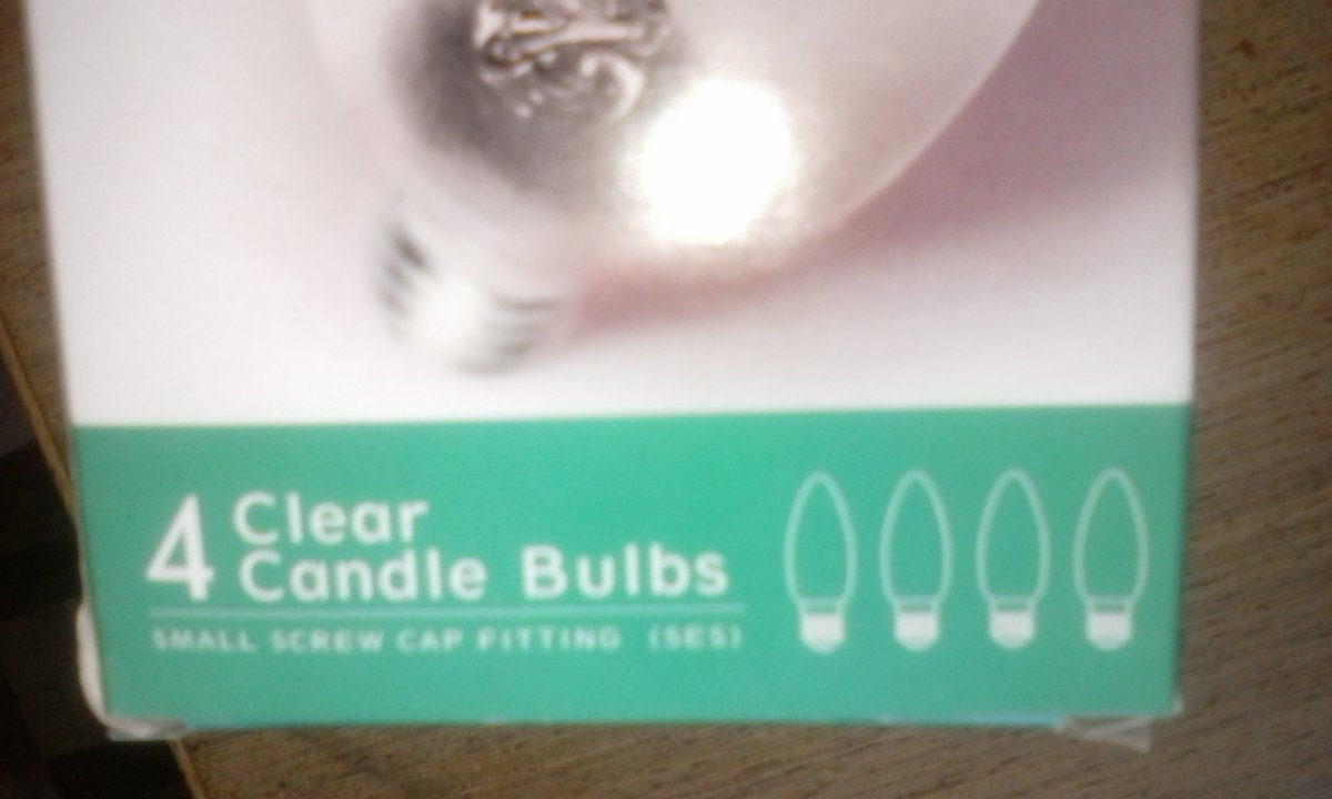

Do you know what?
I knew those b@st@r@s miss sold me, I purchased some bulbs and planted them but the bl@@dy things never did grow
Never worked as fork andles eiver.
Tell me something. Who, and when, decided that bulbs should be called lamps and lamps should be called luminaires?
And the only dazzling display in the garden these were capable of involved some of that fangled lectrickery stuff.
