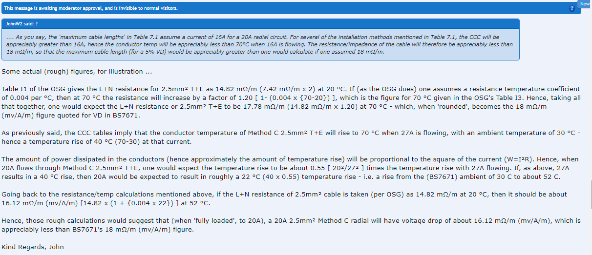

.... As you say, the 'maximum cable lengths' in Table 7.1 assume a current of 16A for a 20A radial circuit. For several of the installation methods mentioned in Table 7.1, the CCC will be appreciably greater than 16A, hence the conductor temp will be appreciably less than 70°C when 16A is flowing. The resistance/impedance of the cable will therefore be appreciably less than 18 mΩ/m, so that the maximum cable length (for a 5% VD) would be appreciably greater than one would calculate if one assumed 18 mΩ/m.
Some actual (rough) figures, for illustration ...
Table I1 of the OSG gives the L+N resistance for 2.5mm² T+E as 14.82 mΩ/m (7.42 mΩ/m x 2) at 20 °C. If (as the OSG does) one assumes a resistance temperature coefficient of 0.004 per °C, then at 70 °C the resistance will increase by a factor of 1.20 [ 1- (0.004 x {70-20}) ], which is the figure for 70 °C given in the OSG's Table I3. Hence, taking all that together, one would expect the L+N resistance or 2.5mm² T+E to be 17.78 mΩ/m (14.82 mΩ/m x 1.20) at 70 °C - which, when 'rounded', becomes the 18 mΩ/m (mv/A/m) figure quoted for VD in BS7671.
As previously said, the CCC tables imply that the conductor temperature of Method C 2.5mm² T+E will rise to 70 °C when 27A is flowing, with an ambient temperature of 30 °C - hence a temperature rise of 40 °C (70-30) at that current.
The amount of power dissipated in the conductors (hence approximately the amount of temperature rise) will be proportional to the square of the current (W=I²R). Hence, when 20A flows through Method C 2.5mm² T+E, one would expect the temperature rise to be about 0.55 [ 20²/27² ] times the temperature rise with 27A flowing. If, as above, 27A results in a 40 °C rise, then 20A would be expected to result in roughly a 22 °C (40 x 0.55) temperature rise - i.e. a rise from the (BS7671) ambient of 30 C to about 52 C.
Going back to the resistance/temp calculations mentioned above, if the L+N resistance of 2.5mm² cable is taken (per OSG) as 14.82 mΩ/m at 20 °C, then it should be about 16.12 mΩ/m (mv/A/m) [14.82 x (1 + {0.004 x 22}) ] at 52 °C.
Hence, those rough calculations would suggest that (when 'fully loaded', to 20A), a 20A 2.5mm² Method C radial will have voltage drop of about 16.12 mΩ/m (mv/A/m), which is appreciably less than BS7671's 18 mΩ/m (mv/A/m) figure.
Kind Regards, John
