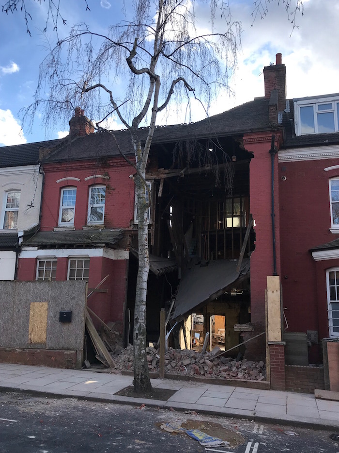

Maybe if we just knock that wall down.

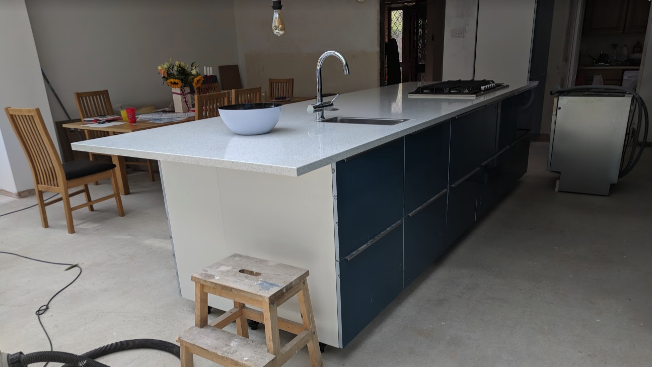

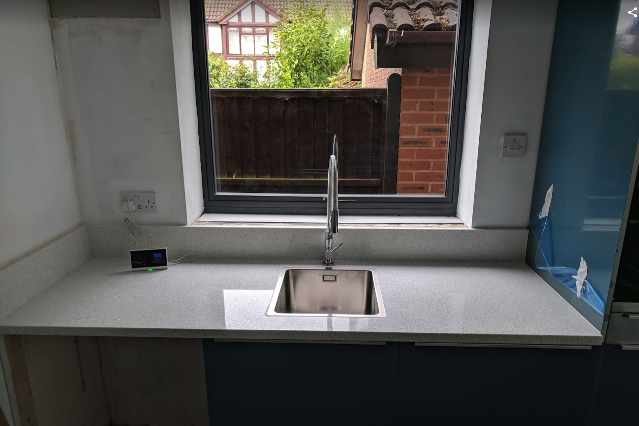

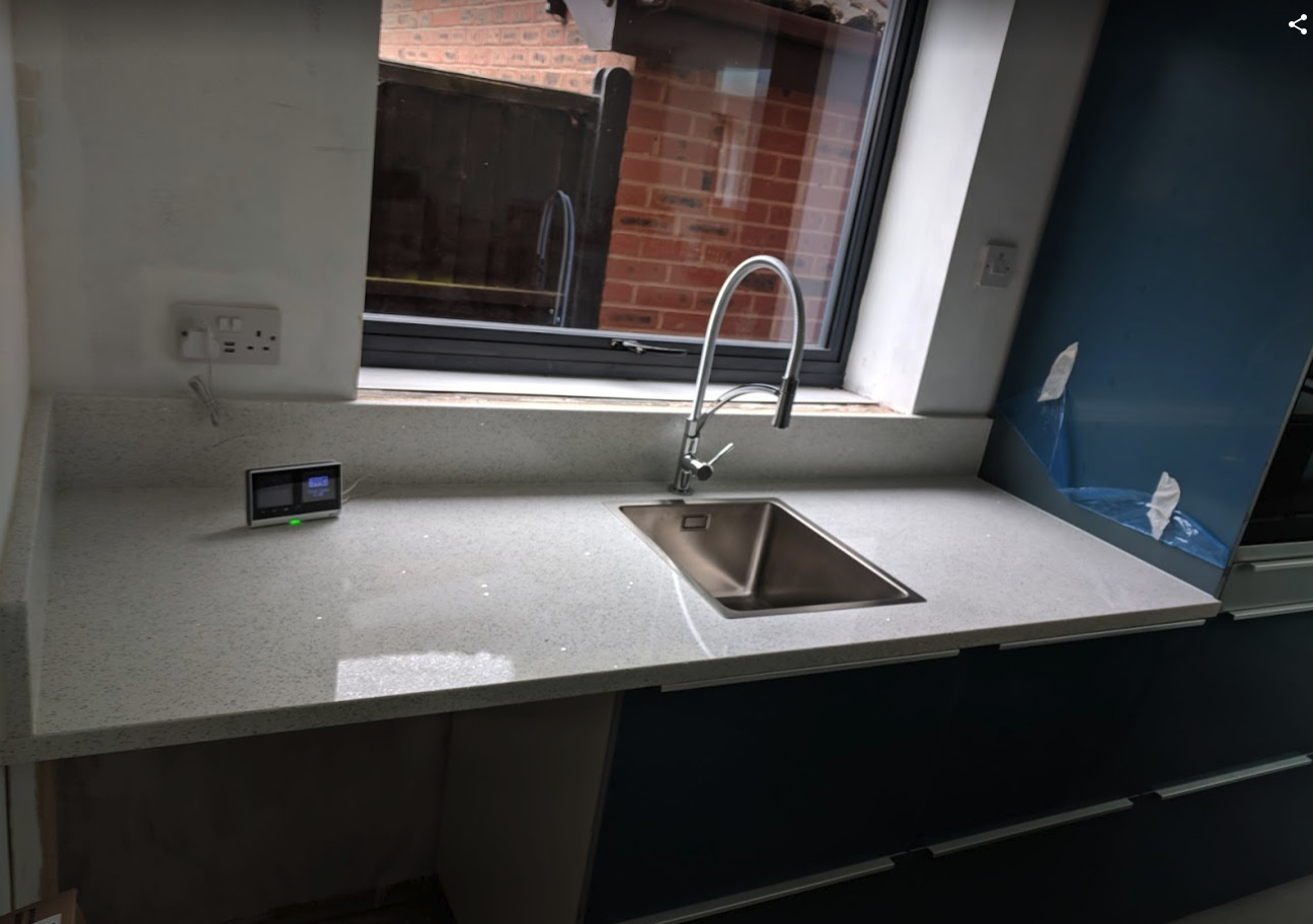

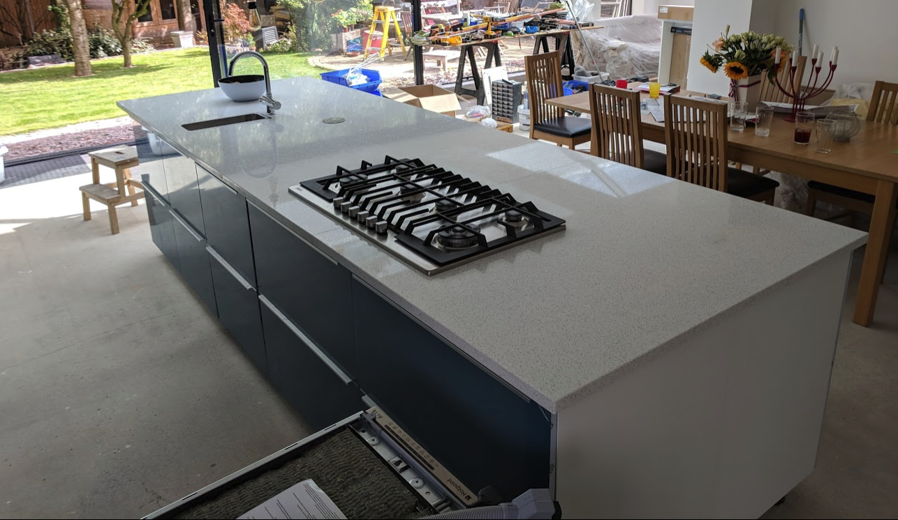

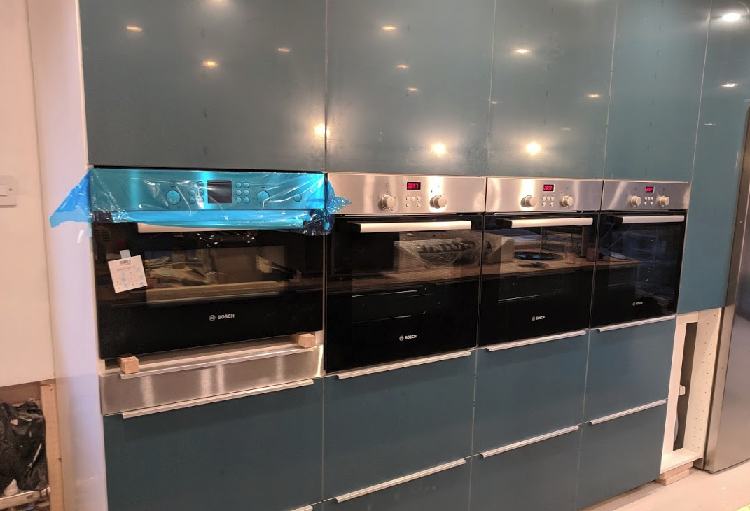

Nearly coming to the end. I'll get some photos of the nearly finished project up soon!
