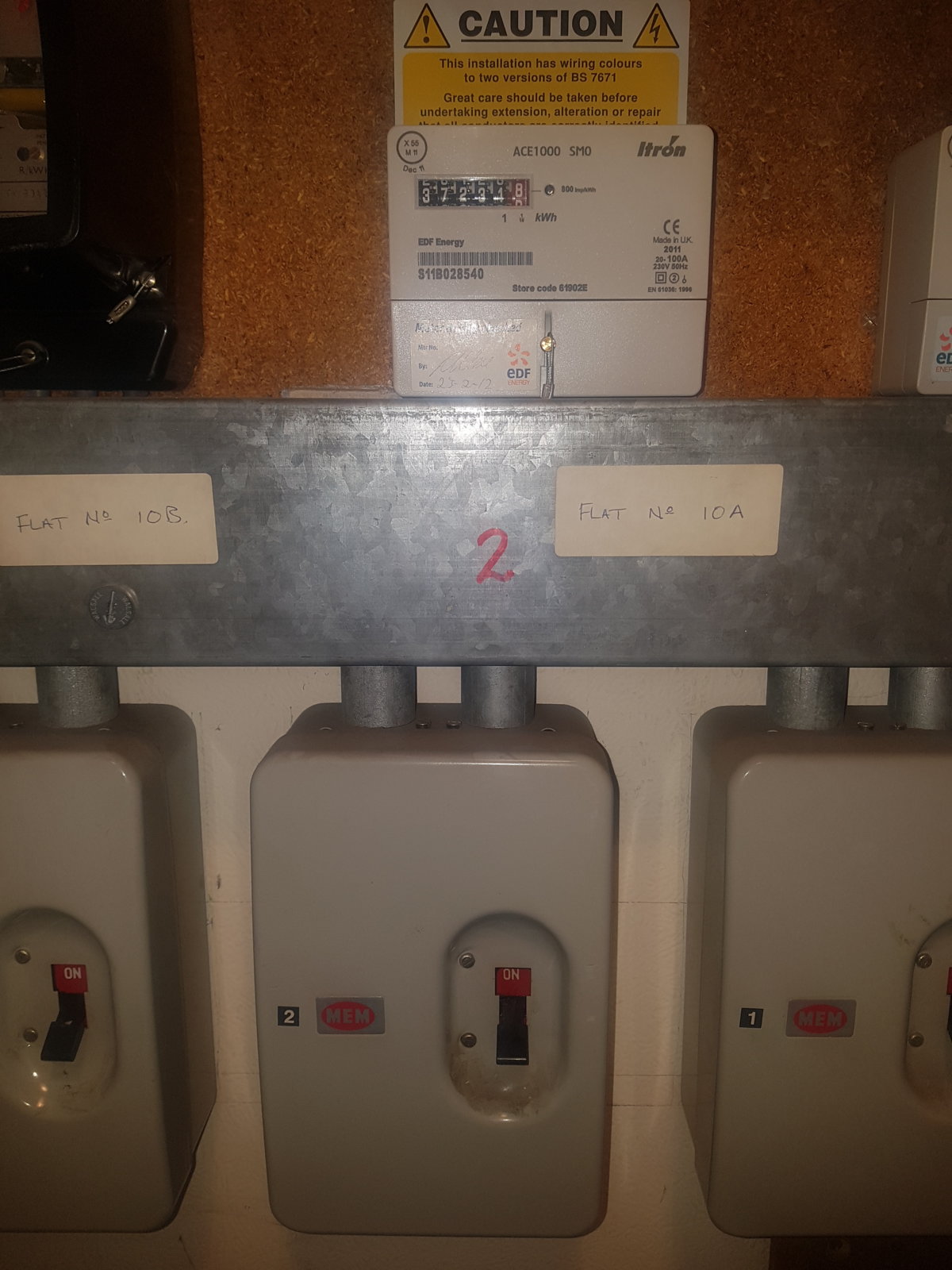

It would be interesting to see some photos. Of the old cables, connections and sockets. Light switches and ceiling roses.
I have just been looking at You Tube for clues.... should I ask them to test for "fault to earth" and/or measure any "leakage current"?

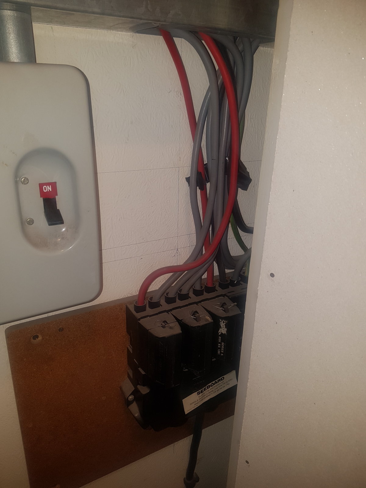

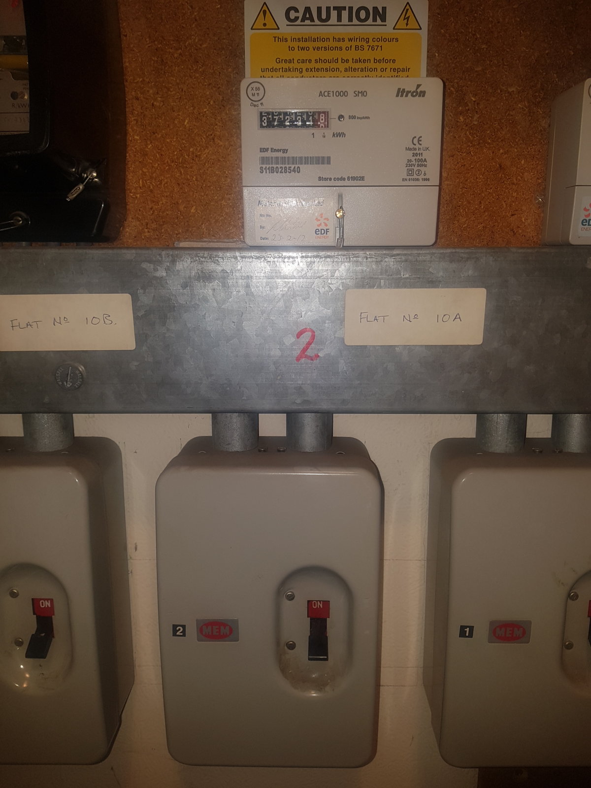

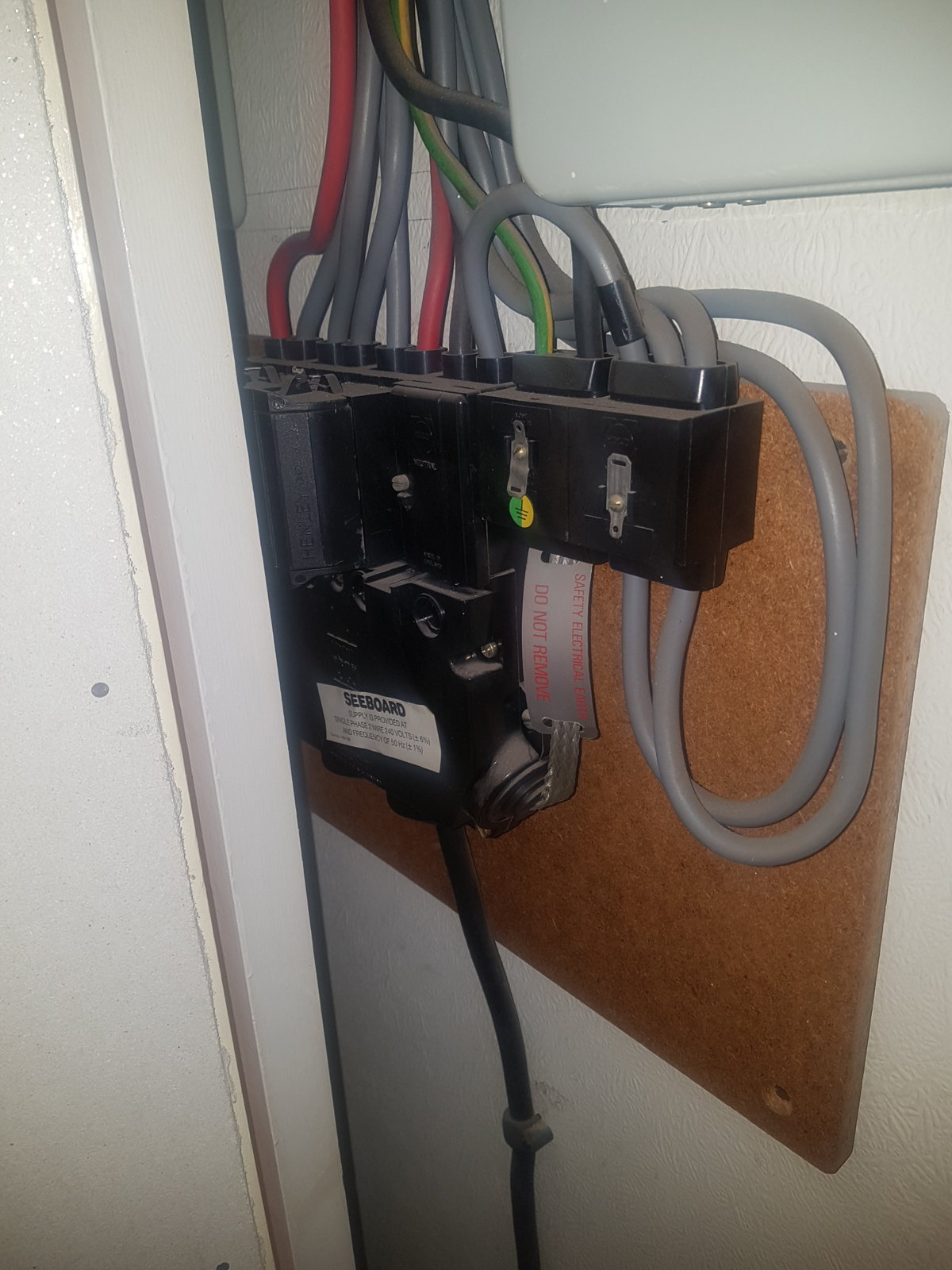

it would also be interesting to see the cables around the meter and CU
there are no wires to be seen around the CU. Just the box attached to the wall. And not much to see around the meter ...
