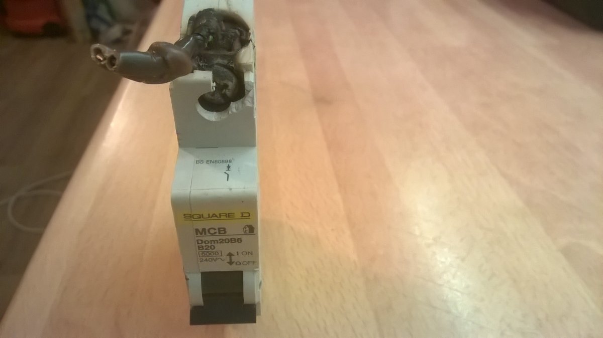

MCB melted

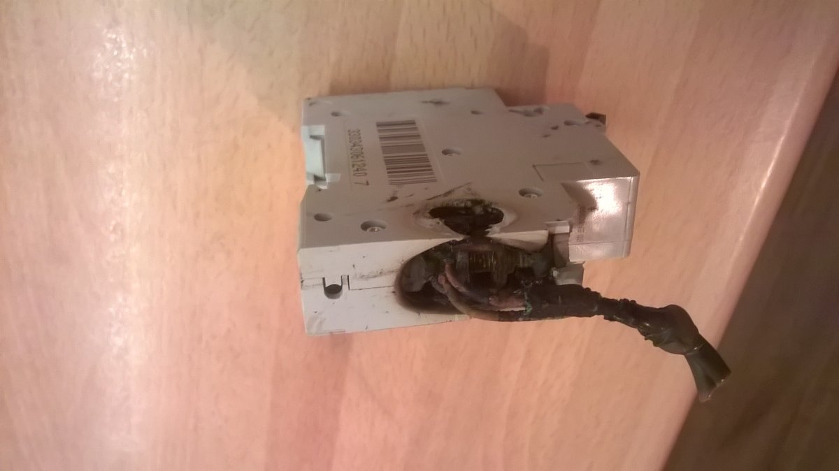

Well here are the pictures hopefully of the mcb. The sparky who came and changed them said he thought they were not tightened up enough and there was nothing to worry about.
Just what I said, first reply :D. Although it was a fairly safe guess, I'm not gonna pat myself too hard on the back. Glad it's sorted though
