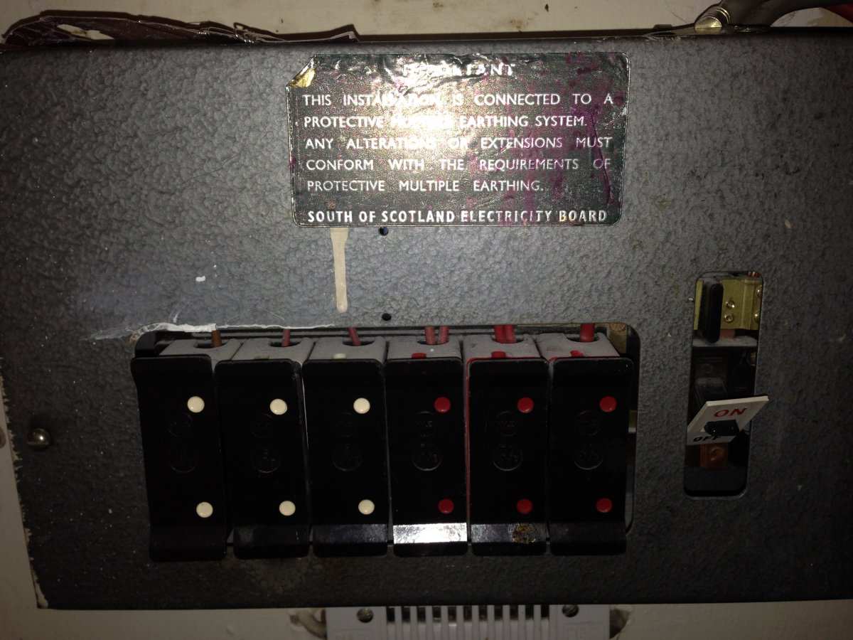

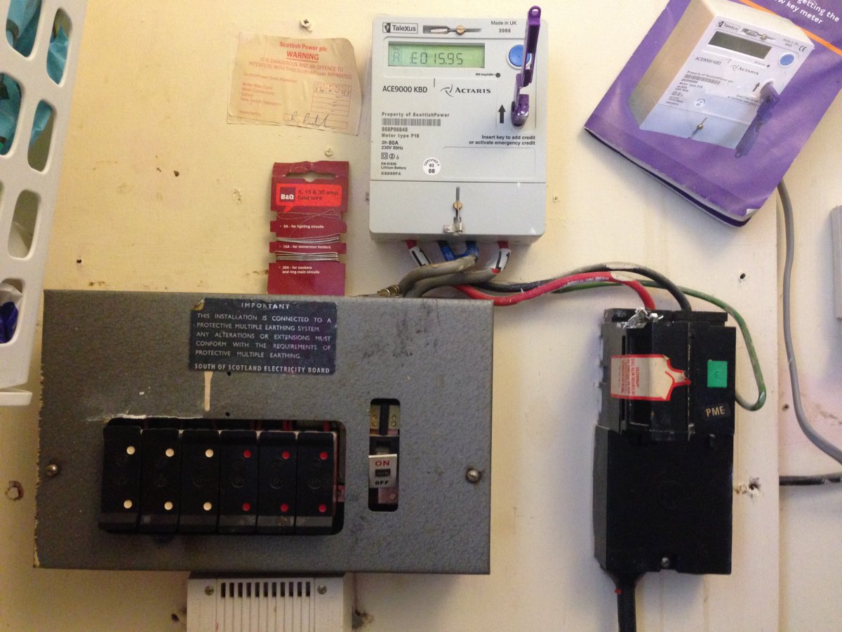

For what it's worth - these are some photos of the old fuse box that was here when I bought the house. So I guess I'm marginally better off now than I was 11 months ago (only just!).
And from that it looks like the old cooker cable was connected to a red 30 amp fuse, not to say the circuit aint been altered since hence the 6a mcb
PS the prepayment meter is also gone now. It was there when I bought the house. x
The old board was unsafe - you can see bare copper - live parts that can easily be touched - behind the main switch.
So, the new consumer unit is marginally safer from that point of view, but it is not right at all - for all of the reasons given in the previous posts.
