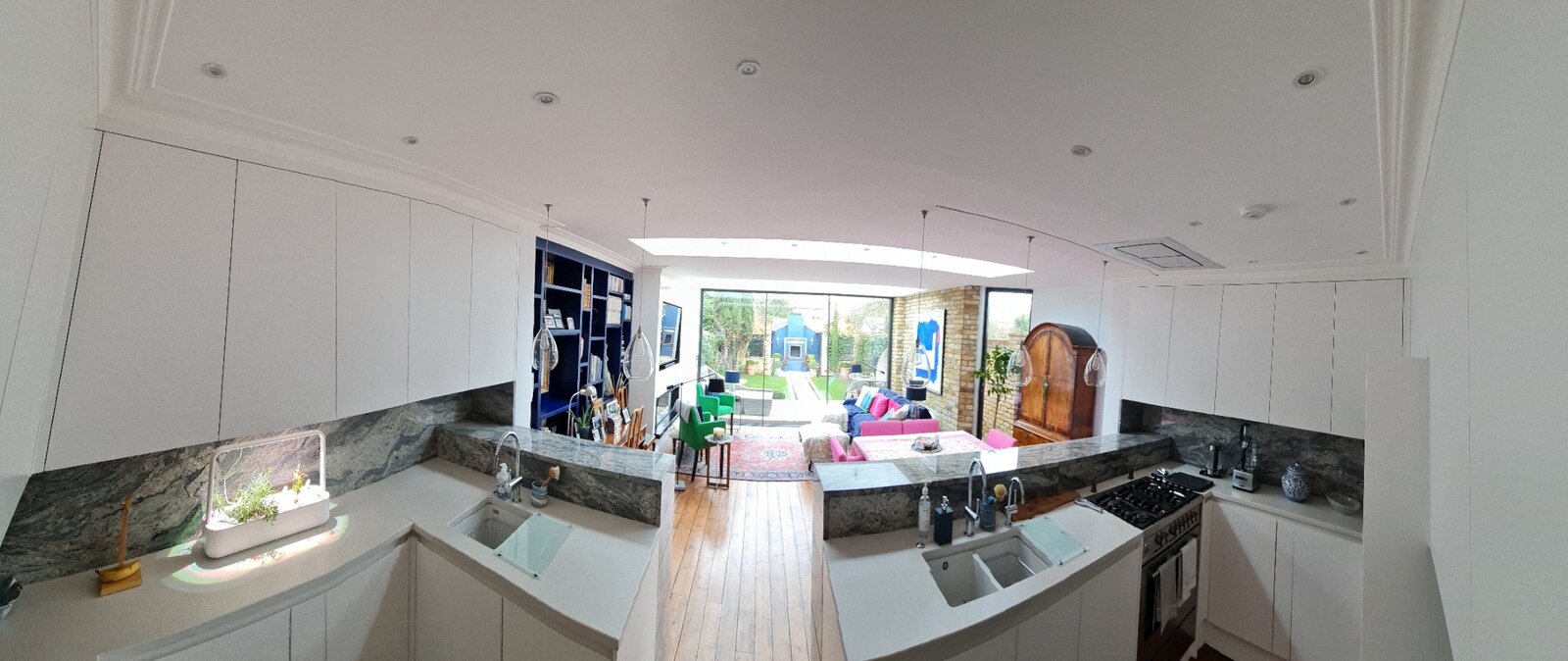

Here is a (not very good) panoramic photo of the room.
There are a total of 45 LED bulbs. The recessed ceiling lights are GU10 LEDs, there are three LED pendant filament lights and the rest are low profile circular LEDs under the kitchen wall units and then LED downlighters in the two skylights.

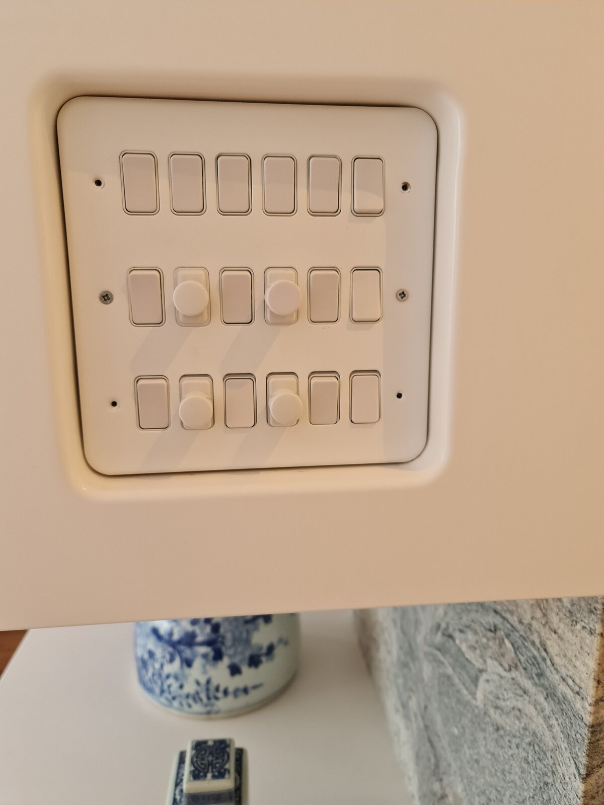

This is the light switch grid

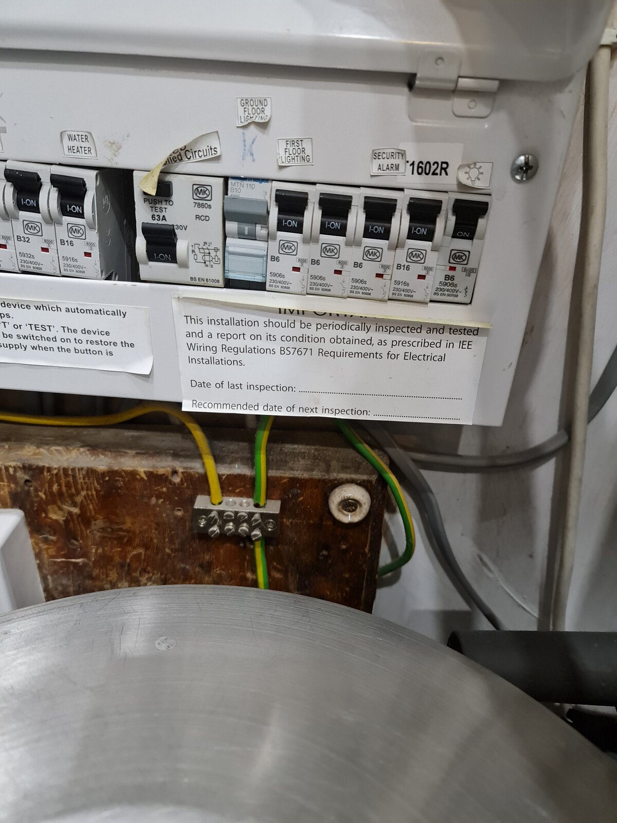

And here is the MCB- the consumer unit is MK but the MCB (10 amps) is a Hager MTN110
The above is the right hand side of the consumer unit. Incidentally, there is no blank plate to the left hand side of the rcd (ie there is a void) and all of the MCBs seem to be slanted...
Hope the photos help, thanks once again.
