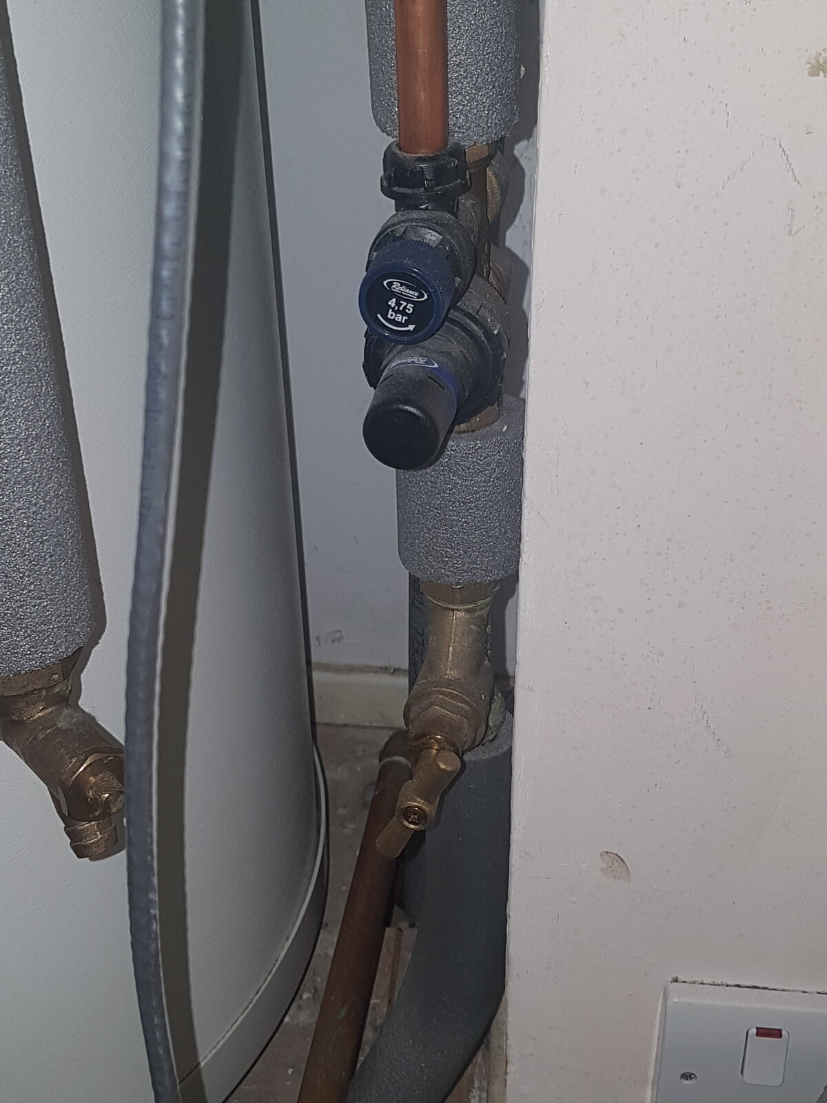

and then feed this into the cold supply of my cylinder before any of the valves etc
That will result in your bacteria laden warm water appearing at some of the cold outlets, as an unvented cylinder should have a cold takeoff for use with mixer showers and similar, so that the pressure of the hot is identical to the cold.
Would the cold takeoff be below the floor as I can't see any pipework going to cold taps after stopcock on cold feed to cylinder.
Or would connecting pre heated water after the valves in picture prevent preheated water appearing at cold taps?
Picture is inconclusive as it only shows a very small section of the pipe.
You CANNOT connect anything after the valves. They are safety devices, anything connected after them would remove the safety features.

Flameport, what if I connected pre heated water before valves with a closed stopcock below it, so that pre heated water can only feed cylinder, and the original cold feed feeds taps, shower etc.
