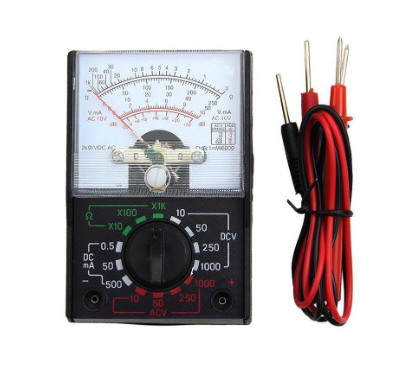

Hi thanks for your reply. The meter looked very similar to this picture.
No I never use the meter to measure amps.

IF everything we have been told is correct/true, then I presume the meter must have developed an internal fault - it appears that the meter only had two sockets into which to plug the leads (so not possibility of connecting them incorrectly), and the OP wrote that "I set the meter to the 250V ac range.".
Kind Regards, John
1) The picture shown was only 'like' the OP's meter, so may not be identical.
2) It is reasonably easy to switch the wrong end of the switch (the one without the dot) to the required setting without realising.

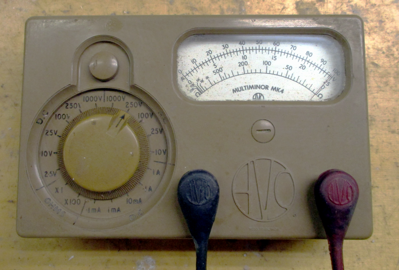

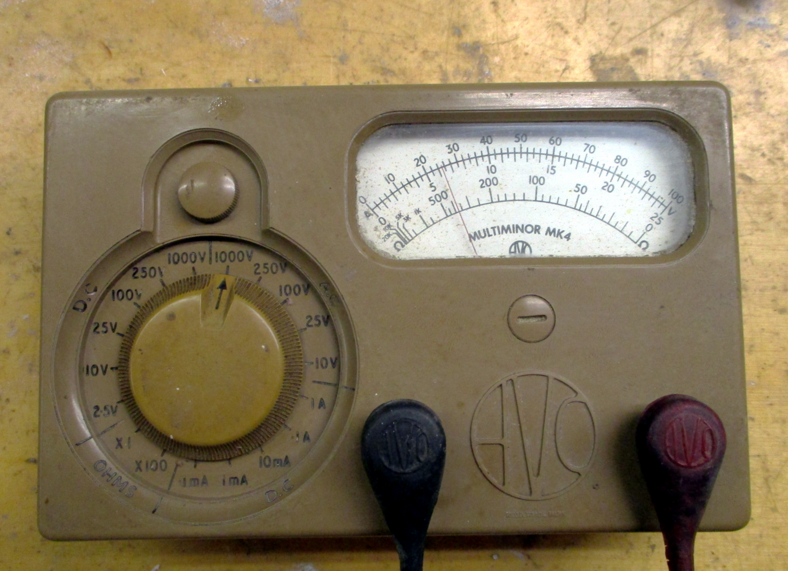

... and just to prove it (and I'm still alive, despite there not being a CAT III/IV marking in sight!) (I guess I bought this one around 1964/5)...
Kind REWgards, John
