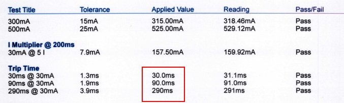

Just recently got my Megger MFT 1730 re-calibrated by Britannia Test & Measurement and it passed. :D
Just wondering if it will fail calibration in 12 months from now based on how close some of the readings were to the Tolerances? Would be a heart break to me if it failed calibration and wondering how much such things cost to repair when they fail calibration tests?
See PDF for test results via the link below.
https://drive.google.com/file/d/16NCQvSLVys0O3p2uogIbLxhXKNY0i2aQ/view?usp=sharing
Regards: Elliott.

Very unlikely anything will change over the years - modern electronic components do not drift in value much or at all, and unlike older items there are no manual adjustments inside either. Any corrections are done in the firmware.
If things go wrong with modern test gear, they are far more likely to go wrong in major, obvious ways such as it not working at all.
Which ones - all of those look to be well within the specification.

And regulation says continuity needs to use at least 200 mA, some of my meters actually use 25A, this is not a fail, yet you sheet shows there is an upper limit as well as lower limit so would worry a little about that calibration house.
I agree, My robin kit hadn't been calibrated since 2006 (but I don't do any testing which requires it) I happened to be in a workshop where a contractor was testing everything in site. The calibration certs for the 3 testers had negligible variation over the 11 years.
Your test figures look fine to me

How do you "apply" a time to a tester?
Interesting question, but the implication appears to be that they have some 'box' which will disconnect the supply 'exactly' 30.0. 90.0 and 290 ms after appearance of a 30mA L-N imbalance, unlikely though that may seem.
Why is that unlikely? How else could the meters stated disconnection times be checked and verified.
