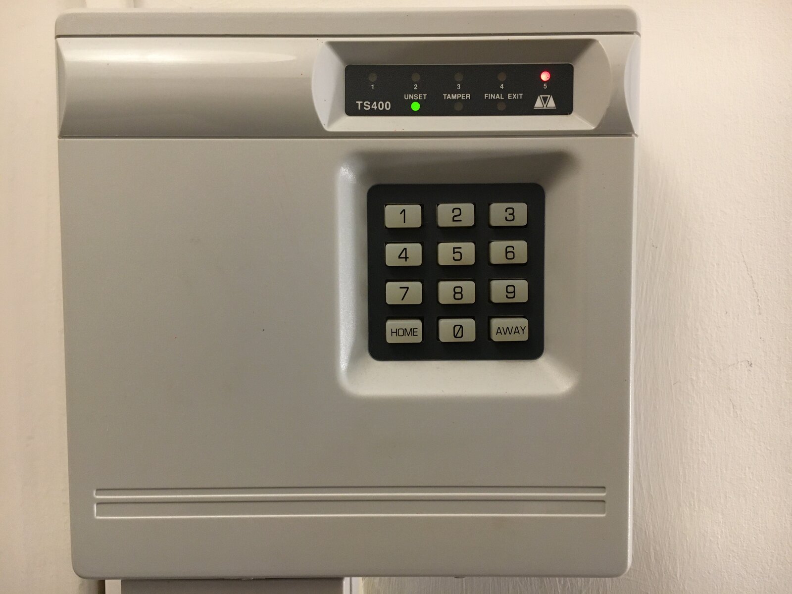

There are two hand-push panic switches. One was screwed to a window sill, which I removed and coiled with its cable in a corner of the room and forgot about (the alarm went off while I did this because I had to take apart the switch to take it off the sill, but reset fine when I was done). It's recently been knocked by one of my kids and since then I get a red light on the '5' on the control panel. Any ideas on how to rectify this?

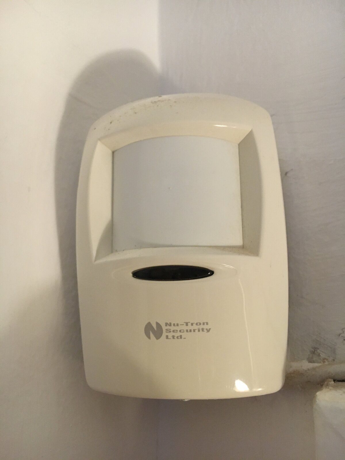

There are a couple of PIR sensors. One of them emits a 'click' every time anyone in the room moves, which is pretty annoying. I'd like to replace it and wondered if this was easy. (If you can recommend which make and model to replace it with that would be useful too.)

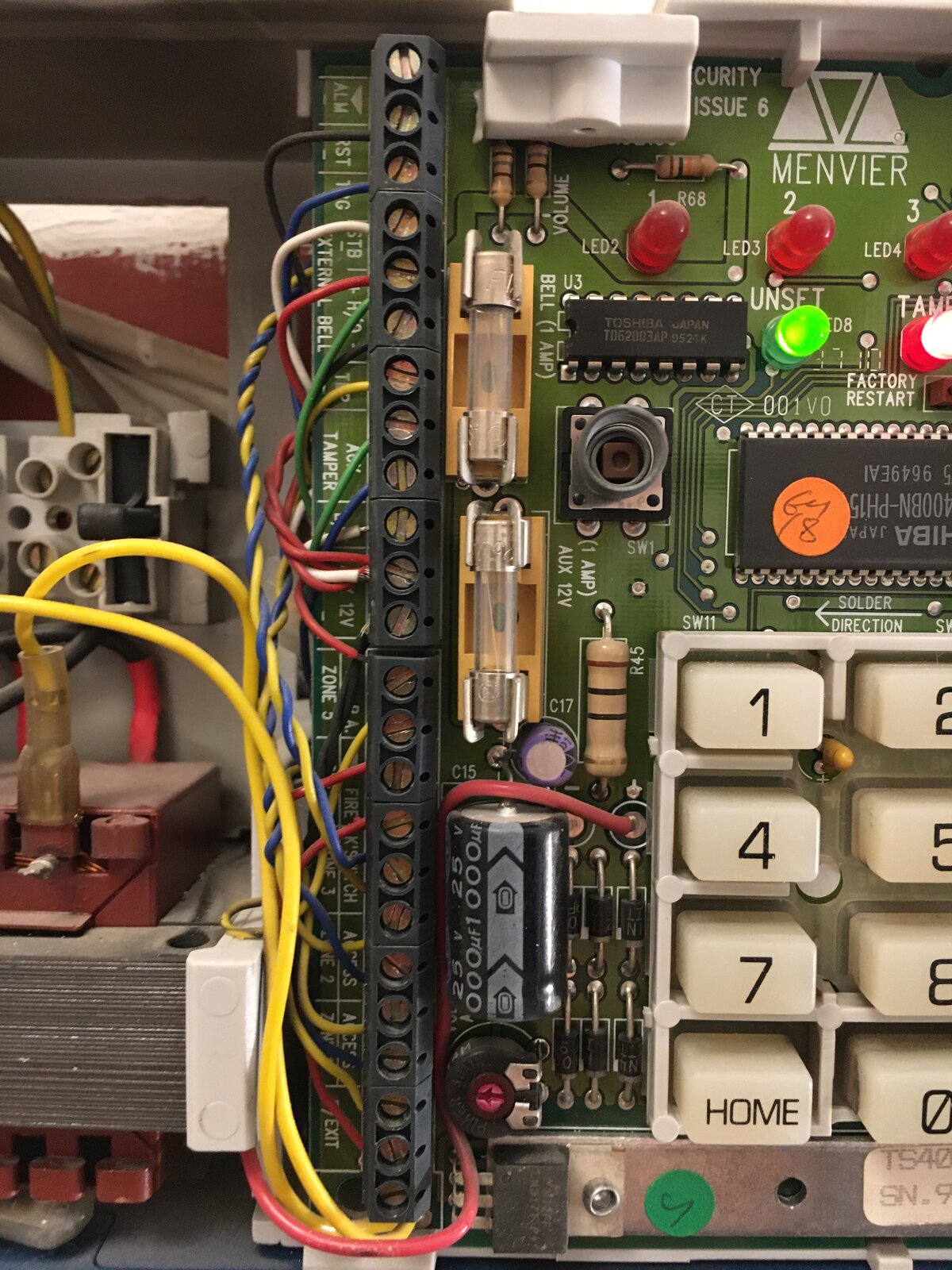

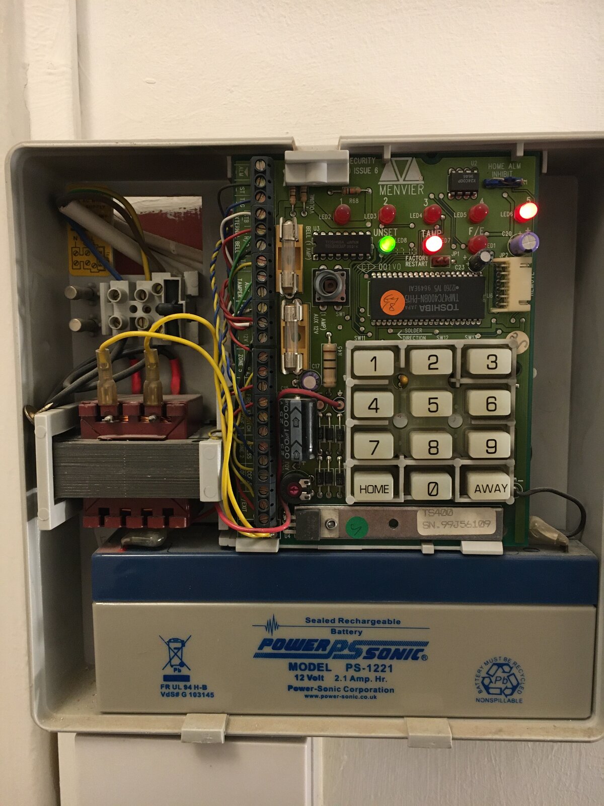

Take photo of wiring of alarm control pcb.This will help with answers to your question.
I'm struggling to get anywhere with this. Is there someone in this forum who knows this model and could walk me through it on a video call (FaceTime/WhatsApp etc)? I would be happy to pay for your time...
Thanks - here you go.

Zone 5 PA has a red and yellow you will need to remove these and replace with a wire link in zone 5.
You may also need disconnect global tamper from PA circuit if connected. Can not tell if connected from photo.
Try linking out zone 5 first.
Thanks so much - (and forgive me if I'm being dense, but) you mean running a short wire between the terminals where I've taken out the red and yellow on Zone 5, right? Is there any danger I will set the thing off if I do this? (Neighbours getting a bit tetchy...)
And also, are you assuming that zone 5 is where the panic switch is connected?
Thanks again, Handymanjo. Really grateful to you for sticking with me on this. That seemed to do the trick! Once I reset it, the zone 5 light went off...

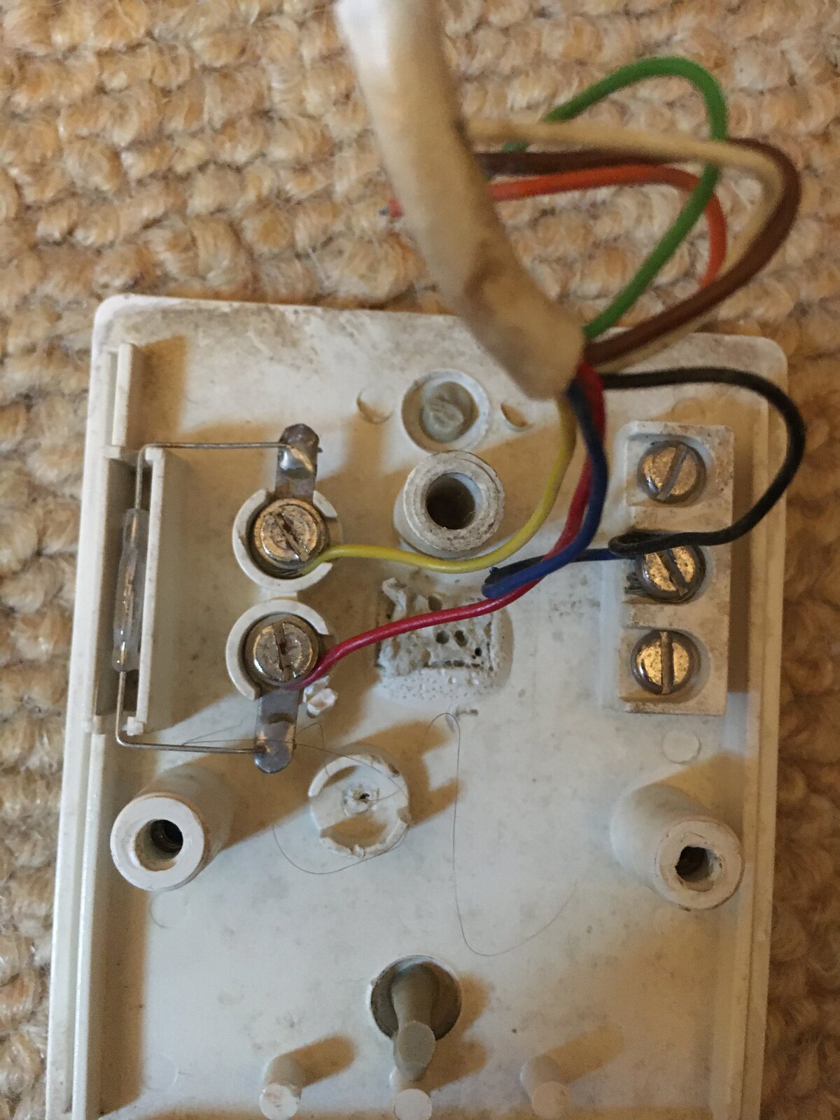

I thought I'd then be able to remove the panic alarm but as soon as I did, the TAMPER light came on. Do you think there's any way I could disconnect this completely or is that more involved? (Inside the panic alarm there is a black and blue wire - pic attached.)
Also, can you recommend a PIR sensor to replace the one pictured? Mine 'clicks' every time someone moves in the room...

The pir may need to be replaced as that model has issues with the lens breaking down.
Pyronix kx quad pir or optex saver or Texecom compact.
The panic button will need the tamper wiring disconnecting in the control panel.
If not confident with that you could just disconnect the panic buttons from the wire and link out using the existing wire. Twist red and yellow together and terminate in choc connector and then twist black and blue together and terminate in choc connector. Not ideal, but easiest way without changing wiring in control panel.
