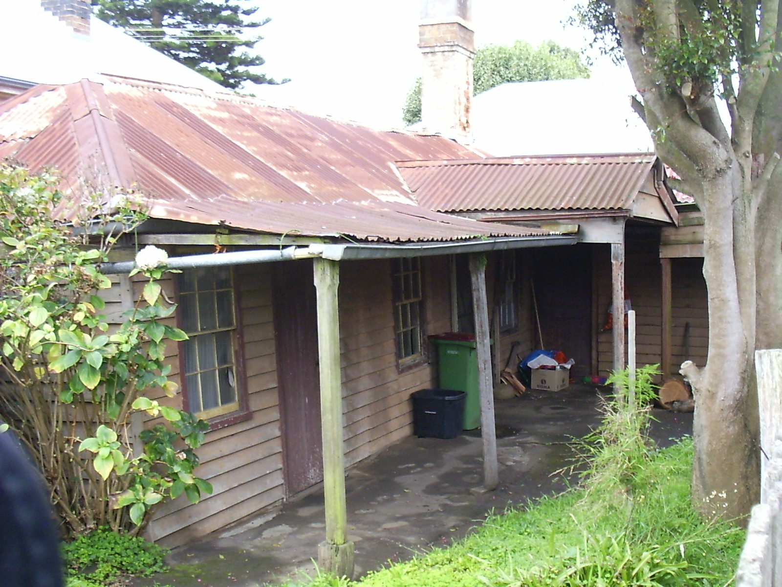

It still looks solid:D few years left in it.

I rest my case ;)
Well, what else can you do? You have posted a photo of an old corrugated steel roof, with no clue as to how long it had been there, on a tumble down construction. I fail to see what it really proves.
What I can say is my now 10 year old modern box section corrugated roof on my 24 x12 garage plus an extra workshop area - is absolutely fine, not a hint of rust anywhere.
I haven't posted any pictures of old corrugated roofs. :censored:
