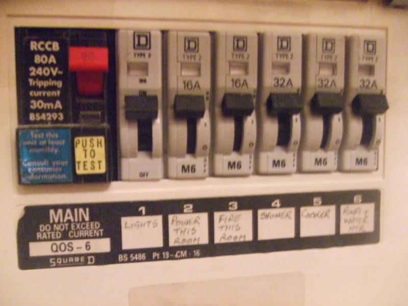

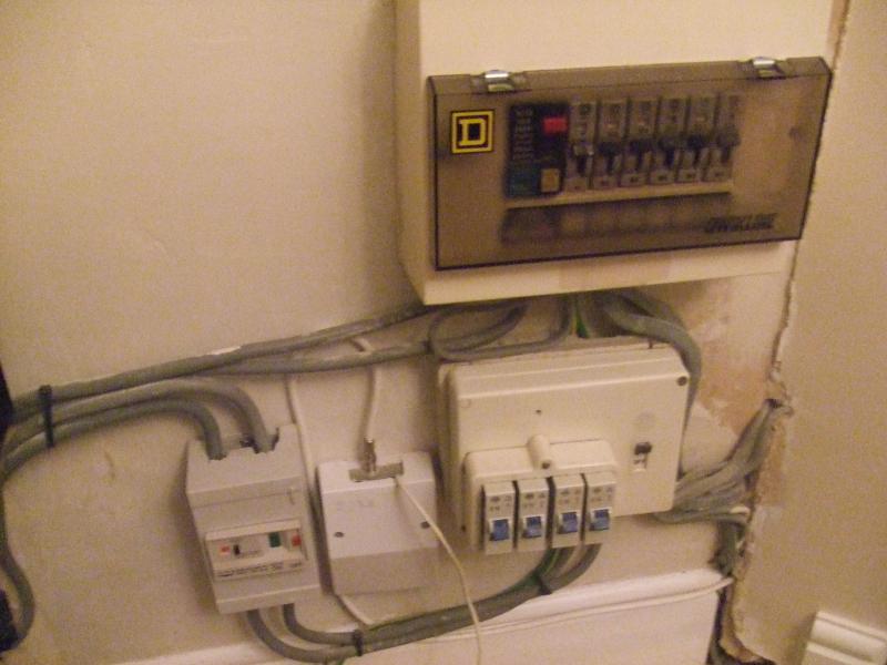

Hi Guys

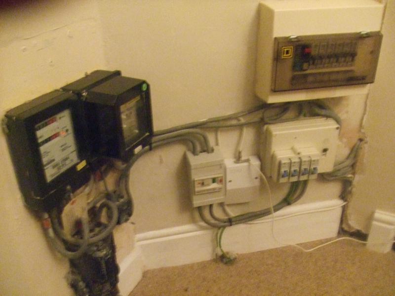

I've had a letter from Eon saying they have to replace my meter because it's past it's life span.
My question is, should I ask if the can put an isolator in so I can get work done on the consumer unit? (will need it changed when storage heaters come out and central heating goes in next year.)
Also I think I have a TT system, do you think they will change this to a PME and will this cost me anything? They aren't charging for changing the meter.
I have posted some pics because I know you luuurve them lol.

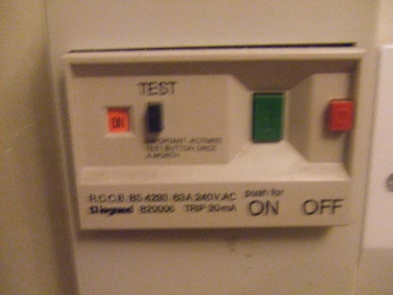

Also the RCCB for the wylex E7 board doesn't trip when you press test, plan to get this changed before we start using storage heaters again.
Thanks in advance..
I can't give any advice on the earth, although I believe (as I also have a TT earth) that TT systems usually use a small earth cable to the gas and water pipes, as the main earth protection is via an RCD. I believe that if you went PME you should really uprate those cables to 10mm. With regards to the Isolator, when I had my meter changed for the same reasons they said that they only put in isolators when the supply was overhead. Mine was done by Scottish and Southern though.
The meter fitter will not be able to convert your supply to PME, it would have to be a separate job carried out by different workers. Whether or not they would consider doing this for free, who knows, you'd have to get in touch with the DNO via your supplier and see what they say.
As for the isolator, perhaps if you provide ample coffee and biscuits then the meter fitter might be able to help you out. The alternative is to have an electrician in to fit you a DP isolator, with good timing and a little work in advance the work could all be carried out at the same time without another visit from the DNO to pull the service fuse.

The RCD will not trip during the day. There is no power to it!!!! ;)
Test it at midnight tonight and let us know
