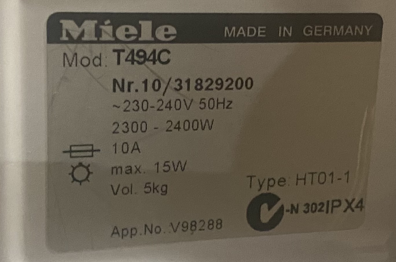

Interesting, I've not seen a Miele with the M-Nr not present. Looking at your profile, this machine is not in the UK or an EU market?

Thanks very much Honj for putting all this together. This machine is in the land of “Downunder” (the controls are at the bottom of the machine ). I tried the initiation sequence several times but unfortunately it didn’t generate a flashing START LED. I recall seeing somewhere about holding the Start & Short buttons down which I tried. This resulted in the Drying LED flashing but I was unable to achieve anything else.
