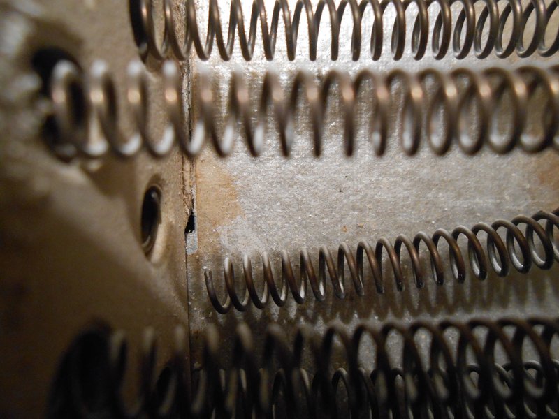

There was no continuity in one side of the element, and I finally found the cause of my problem.
So I took the element apart

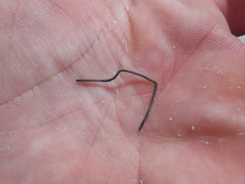

A wood staple from a pallet, I usually collect them in my pockets, it seems this one hid in a wrinkle when I emptied my pocket.

Can a break like this be fixed with some reconnection of the brocken bits, or only by replacing the entire length of wire?
You could attempt a repair.
Pull the end of the heater wire through the ceramic hole and twine the two ends together. The tension in the 'spring' should hold it together as well.
Providing the spring is not stretched too much causing it to sag (remember that when it heats up the wire will expand and sag more) and make contact with the lower wire or make contact with any other surrounding metal casing etc (remembering that the motor air flow will blow it about if sagging too much) it should work fine probably for many years to come.
Not sure how much these elements are but sure they are much more expensive than other types. So consider the cost of replacement now but having it working now and being able to prove its fixed the problem and not having to wait for the new part to arrive only to find theres something else wrong, with the prospect of possibly having to strip the machine down again to replace it at a later date.
Is it possible that this was the cause of my problem in the first place one year ago? And we've been using it since. Could be that when we moved, the wire shook out of the position it was in, therefore not short circuiting it any longer, and it just fell back into it's original place now.

Could very well have been the original problem as you described, certainly fits the symptoms.

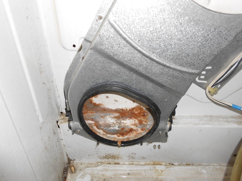

I checked the switch, it was fine, looked into the pump, it was clean, vacuumed every corner, cleaned all the fluff out.

Since the broken wire was unreachable from the outside of the heater, I completely took the element apart, crimped the two ends of wire with a piece of electrical connector, then reassembled the whole dryer..

The lesson learned is, next time anything trips the fuse I should take the time to take the dryer apart. If I would have found the staple a year ago, the heater wouldn't have needed "surgery"...
