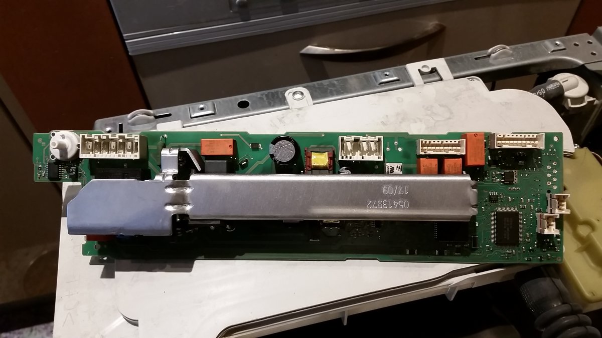

The controller in my machine is a EDPC1000 pn 05413972, it differs from the EL200 one in the thread I found, but my machine exhibited the same display sequences.

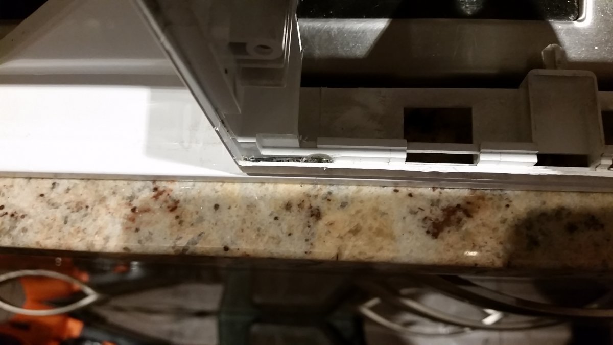

There were a couple of you tube videos on dismantling miele machines so having viewed them off I went, all was going well until I had to gain access behind the control panel front to remove two hidden screws, the third was accessed by taking out the soap dispenser.
I could find no mention of my model machine nor any reference to the front panel, this caused about a three hour delay as I did not want to damage the fascia.
I made a decision in the end to force the front by getting behind it with two blunt knives, it popped out of the housing, then I could see how I should have gained access.
The trick is to push down from the top of the "panel insert",(SEE FOLLOW ON POST VIDEO IGNOR MY METHOD) the upper edge is held up by two flat springs which push up from the bottom, I suggest two blunt knives about 25% in from each end at the top, try and hook them under the top edge push down and it should pop out!

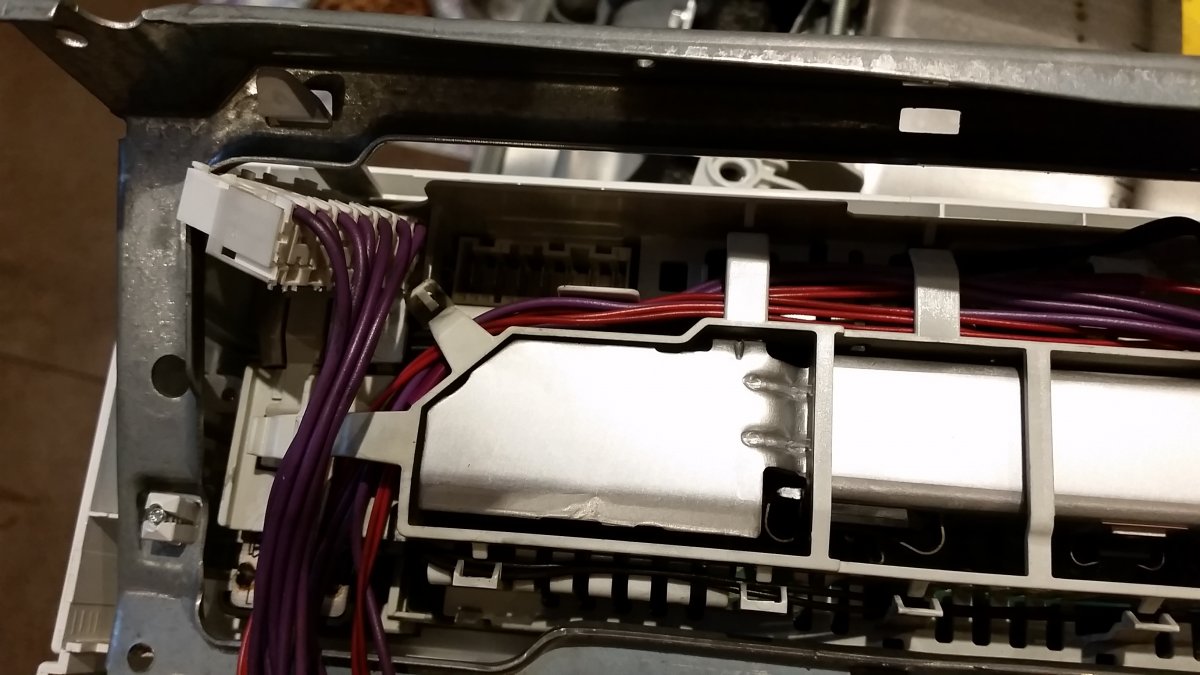

OK the rest was fairly straight forward and I was able to release the control assembly from the frame (I did not need to take the frame out but was getting nowhere with the previous task!)

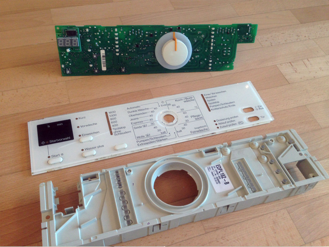

So having taken all the plugs out of the PCB and having removed the plastic cover / guard I found I had not got the EL200 controller!!

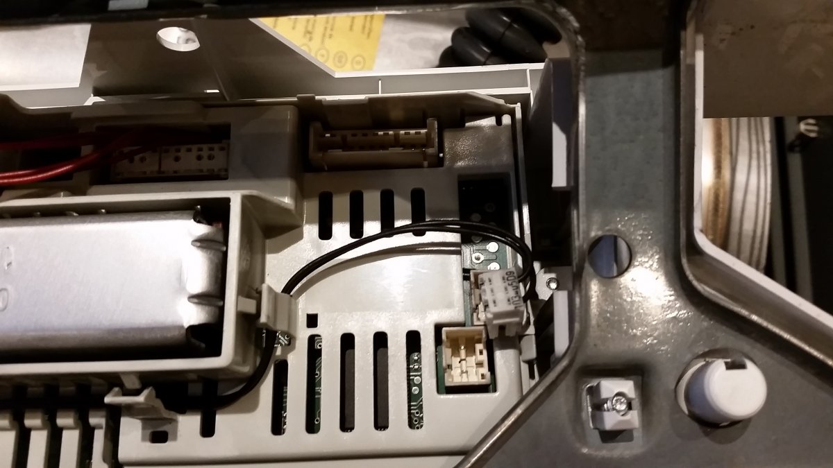

I should add there was a separate panel with the on/off and door open switches on it which slide out of the plastic PCB carrier frame.

A close look at the EDPC1000 I could see no fuse, there was a fuse but it was a 20mm cartridge type on the on on/off / door open switch panel, it checked out OK!

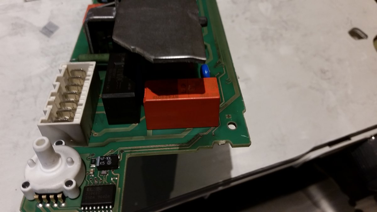

Turning my attention to the control panel itself it did have several relays on it, I traced out the high current paths that feed the motor and they led to a Omron G2RL-2 12V relay with the same footprint as the relay in the EL200 controller, I am an electronics engineer so I used the helpful trick and powered the relay having checked which pairs of contacts had continuity when no energize voltage was applied, the relay clicked but the same contacts remained connected suggesting the relays contacts had welded themselves together.
Just to be sure I tried with the new relay it confirmed my findings, whey hey!
I replaced the relay with the one mentioned in the EL200 thread, I replaced the drum dampers, I noticed they were not as firm as the new ones.

The image with the orange relay and pressure sensor shows the replaced faulty relay, I have no idea what its part designation is but that does not matter.
The cutout in the forground is where the on/off and door switch PCB fits when the front is re assembled.

ps. I hate to admit it, but I wasted time trying to get the front cover off by assuming it hinged at the bottom (given the info about uncliping it). Lo and behold it opens to the side!! (rht side hinges). Finally got this info from a German you tube clip.
