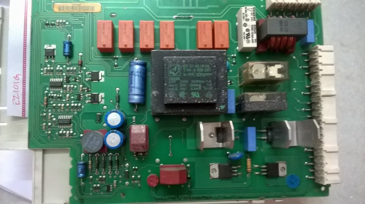

we have the same problems discussed in this thread. However, it is on a EZ 101 G board, ws5425 model. In this picture, i am able to identify the fuse. however, not sure which one is 6k1 relay. can anyone identify which relay is 6K1 in this picture please? i have also enclosed the wiring diagram for this machine.
I am not an expert on pcb's. If you have any further questions to answer my query, ask for your kindness to explain the query a bit more in detail please

Can someone tell me where to find the pcb in question please. I have the lid off and the front panel off and the main control board out (that was a game!) but am beginning to think I am barking up the wrong tree.
Please help!! :(
Hi Bevelsingle,
The main board your looking for sits behind the front panel dial you use to select washes. It's called EL200C or D probably. Hope this helps but if not PM back if you not sorted already.

Hi, thanks to everyone for their input on this post. 20 years of unbroken service from our W842 but now rinse light flashing as per others on this thread. Loathe to send it to landfill without trying theoptions here. Two questions please:
1) Where is the relay that needs to be changed located please? And can this be done with out a solder?
2) Where is the fuse located?
Many thanks.
Look at the beginning of this thread for the link to the original thread describing the fix. Look at HarryKiri's posts and link to his photobucket to see the parts location on the control board.
1) see above to locate. It needs de-soldering for removal and soldering to fit new. No way around this.
2) see above again. Needs soldering too.
With the above pics, any electronics repair shop could do it in 5 to 10 minutes when the board is removed/unplugged as some tohers have done. You could order the parts from RS as others have done and supply to tech person.
Thanks izzywizzy. Found the picture. Will take it to my local electronics repair shop, and replace brushes and shocks also. Many thanks to everyone who has contributed here. I'll let you know how I get on once all parts have arrived.
Many thanks to everyone on here and the original thread. Worn out rushes replaced - and shocks for good measure - and machine is back working good as new. I didn't require the replacement relay and fuse in the end! It was just down to the brushes. No need to buy another machine for the sake of a part costing £5.50! Incredible! Do feel a little let down by Miele customer service however. When I rang and explained the symptoms - flashing rinse light etc - they said it could be anything! Well, it was a good job I found you folk who pointed me straight to it! Thank you.
