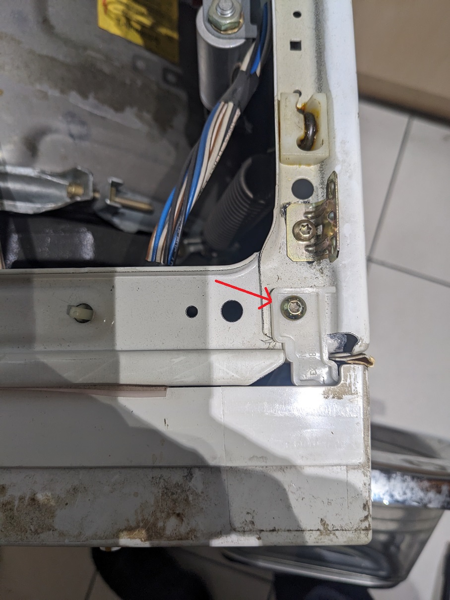

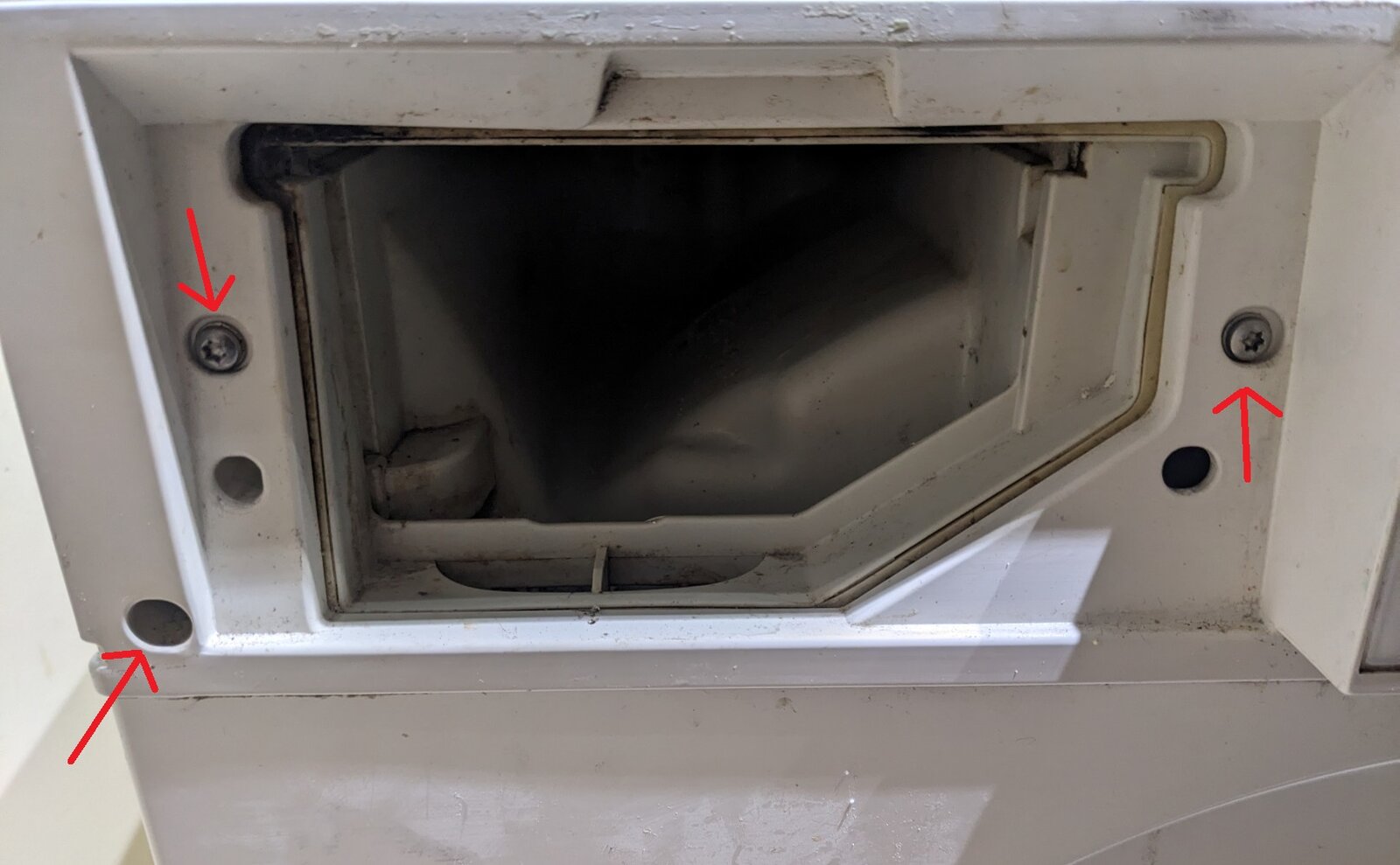

Once you can the top lid off and the drawer for the detergent, on my machine I had to take remove 4 screws - 3 of those are behind the drawer and one on top of the machine (see pics). Also at the bottom of the machine, unhook the drain-pipe and unscrew the fluff filter. Undone the 3 bolts around the door, the whole front of the machine should now swing open, you also need to undone the cables that go into the control panel to get it to fully swing open. I have not removed the side panels on my machine, so not quite sure what the best way to get those panels off. Hope that is helpful.

That last video, the German one, was perfect. The front swings open, just like you said and is shown in the video.
I managed to get the new shock absorbers/dampers fitted in the same way as is shown in the video.
