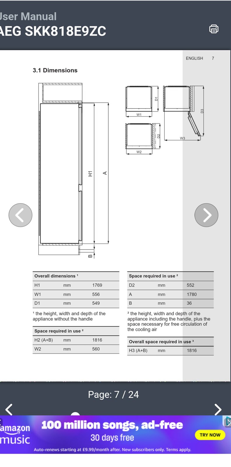

We had our new kitchen installed 18 months ago, and keep having problems with the bottom part of the intergrated fridge freezing the veg.
The fridge has had a new pcb board fitted, and a new thermocoupling (I think). Neither fixed the problem, so AEG have supplied us with a brand new fridge. However, the same seems to be happening (early days yet, but it's already hit zero degrees when it's set at +5⁰)
I've since looked at the installation booklet, and it says it needs a min of 50mm between the back of the fridge and the wall.
The larder unit that the fridge is set in is 570mm deep, and the fridge is 548mm deep, so this is surely an impossibility. As well as that, the fridge sits at least 15mm inside the unit which means it must be almost touching the wall.
Am I missing something?
Please help.
Thank you in advance.
Update. I have managed to get a tape measure above the fridge, and not including the metal work at the back of the fridge, it only measures 520mm. So now I'm even more confused. See attachments.
