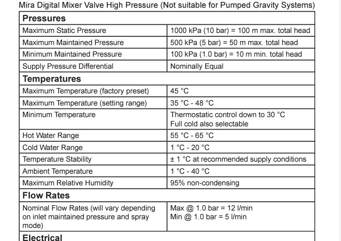

Guys, what would be the implications of using a Mira Platinum pumped digital shower on a high pressure system.
Would it be ok to simply crank down the flow from the incoming hot and cold.
Nope, the pump is designed to have an unrestricted feed from the hot and cold supplies rather than a supply pushed to the pump, which would be the case. Max supply pressure would 1 bar and the mains invariably would be higher than that unless run through a Pressure Reducing Valve (PRV). Then there would be a battle between the flow of the mains and the draw of the pump.

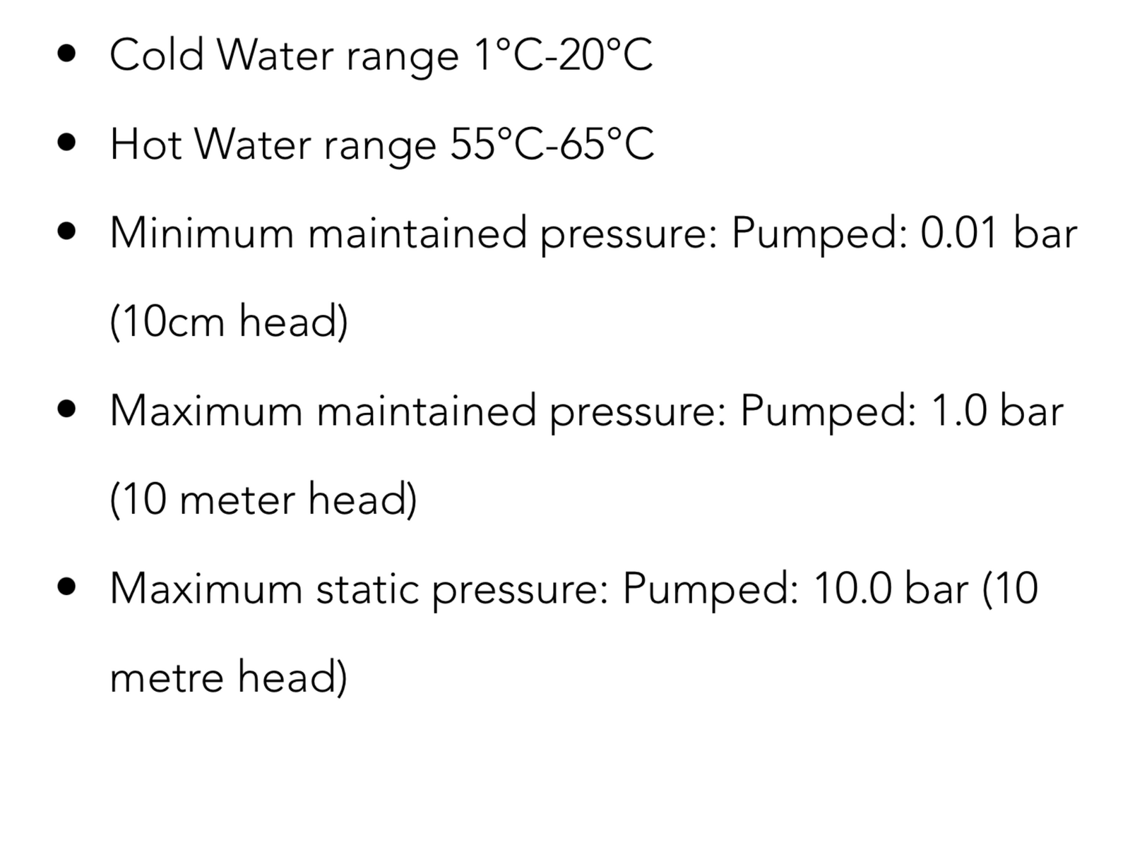

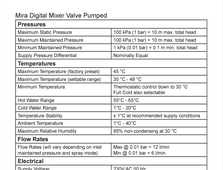

Mira spec for the pumped version is Max Maintained head 1 bar and max static head of 10 bar……..
You don't want to reduce flow. Flow is not a problem - you can never have too much flow capacity, only too little.
You can have too much pressure though. 1 bar will definitely be fine.
'Fraid not - it's specc'd @ max 10m head for both static and constant, that equates to 1 bar for each with a nominally balanced supply. Chances are it may be ok, but I wouldn't ever play around with something that had the potential to cause a fair amount of water damage.
