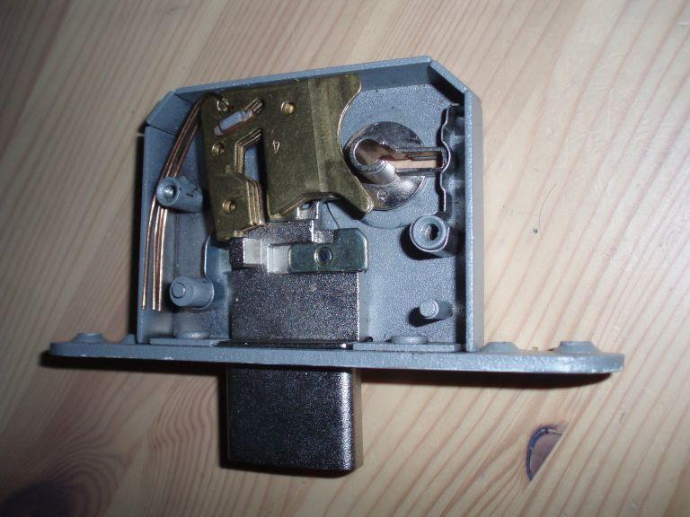

I took the above apart to try to fix it and unfortunately lost one of the levers :( I now have two levers with no 6 and one with no4 and one with no 5.
So can anyone tell me which lever I have lost and where I can obtain a replacement?

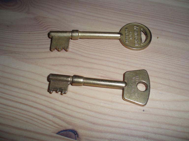

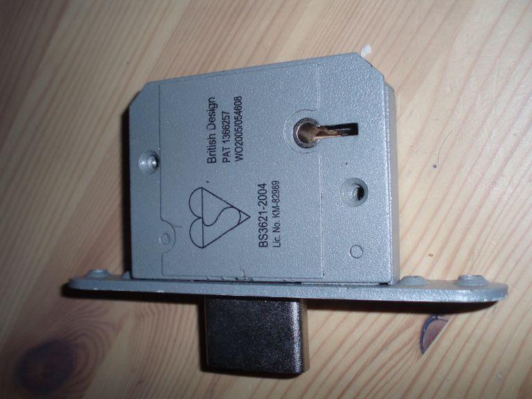

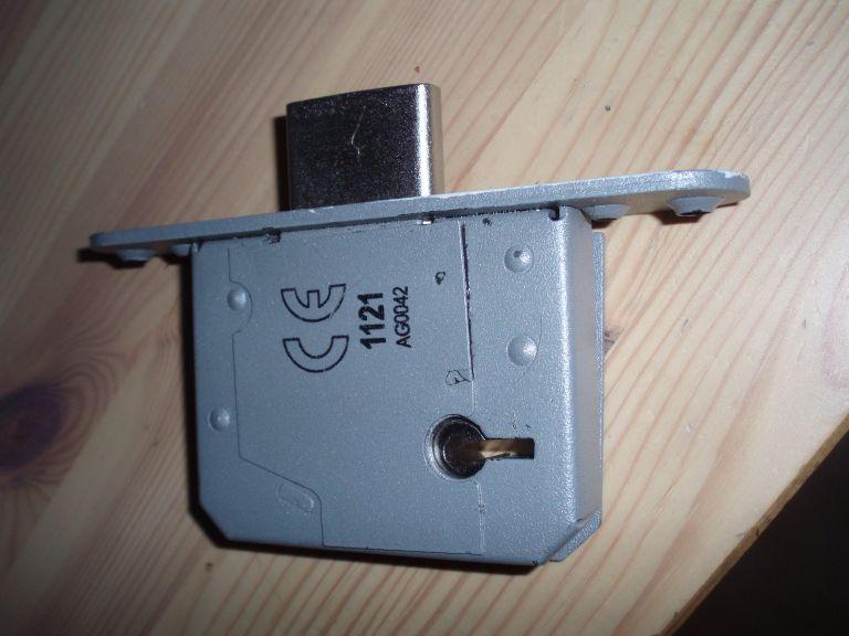

Attached are photos of boths sides of lock, one of it open and another of two keys - I have forgotten which one is the right one for the lock :oops:
I am not sure how to attach but have created an album and assume you can see the pictures from there?

I believe that the lock is a Sterling 5 lever mortice, conforming to the British Standard 3621-2004.
Sterling make locks at the more economical end of the security scale.
I do not have any levers for this lock. My best advice would be to replace it with a Chubb or Union 3G114e/67. The lock case would appear to be of similar size thus needing little work to change over.

That sounds like a great idea :) BUT I tried to do this before (arrange the levers) and completely screwed up. Apparently you have to arrange them in a fan position - is that right? (I just put one on top of other). Is there a set of instructions you can point to? (I guess I could look at what they look like in new lock and just copy that, just aware they might have some spring/tension mechanism that once taken out will be hard to put back...)
Thanks again
Matthew
Set of instructions.
Take the first lever off and put to the left hand side of your work area, take next second lever off and put to the right hand side of the first lever, take the third lever of and put to right hand side of the second lever. Continue till you have the five levers set out in front of you.
Take all the levers out of the lock you are now going to rebuild and place the fifth lever back in taking care to get the spring beneath the post that carries the top screw.
In your photo you have the springs above the post. You can see the marks belove the post caused by the springs resting against it.
Replace all the levers in order that they were removed. Put the top back on and test. Happy that it now works replace the screws.
Or just write down the numbers on the levers as you remove them and rebuild in the same order.
